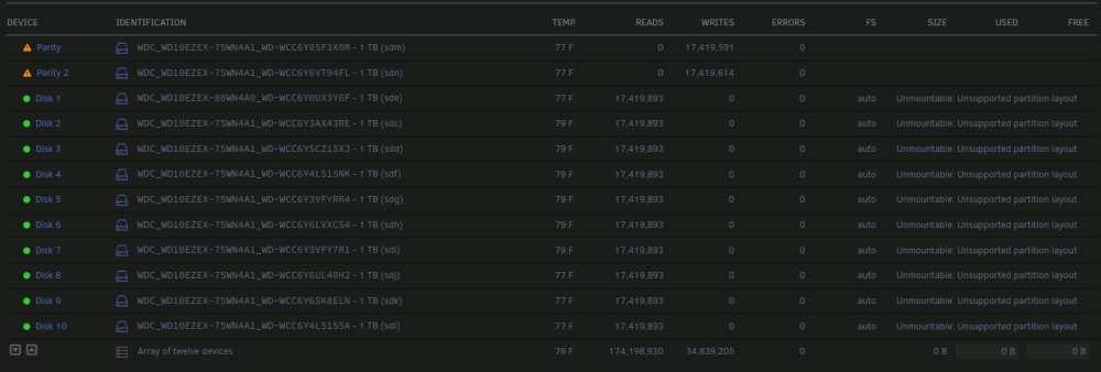

Flashed my H310 to IT Mode and trying to add back array
Hi all, I flashed my H310 mini Raid card to IT mode, and now Im trying to add back my array. I used the Unassigned Drives Plugin to identify my two Parity drives and added them back. Then Added all my Disk 1-10 but i am getting an error message after starting the array.  In the Screen Shot, the Parity is currently syncing. It wants me to format the drives but then I know I will lose my shares. Is there any way I can revert back, I have my old Raid card that I can swap back in. image.thumb.png.d7684159bc45747b4c0095560ee37a0b.png
Solved by JorgeB
Unassign one of the data disks and start the array, Unraid will re-create the partition layout, if that's the only problem the emulated disk will then mount, if it does and contents look correct you can rebuild on top, then repeat for the other disks.
