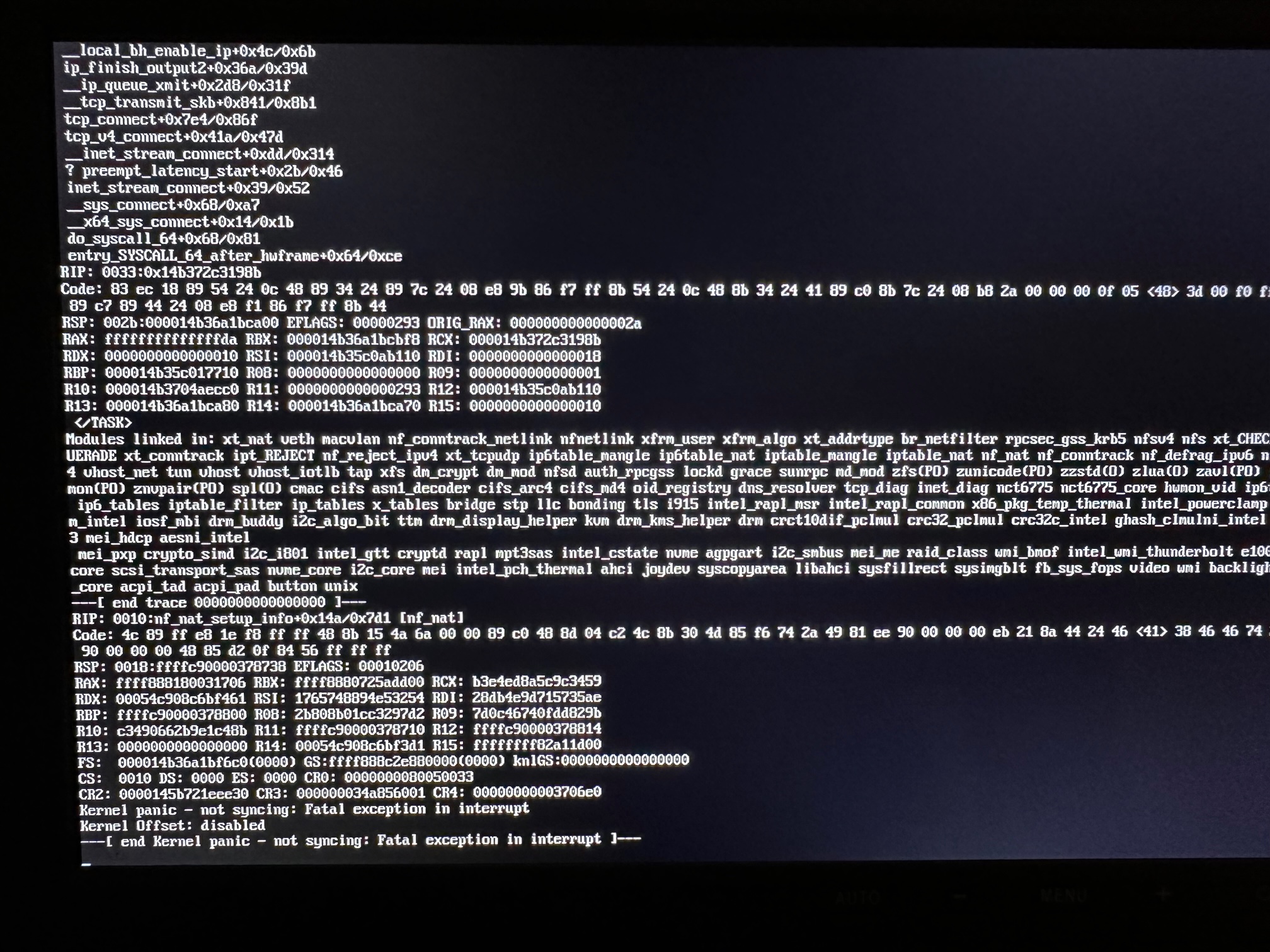

August 27, 20233 yr Hello, since 2-3 months, my two unraid servers are crashing regularly and both seem the have similar crash. last in date yesterday, around 3AM. on this server, it just stopped answering yesterday, no ping, no gui, no terminal on screen, nothing. but last time, some containers stopped working (I guessed because of a mounted share, that causses me issues everytime I want to reboot), then GUI stopped responding but I managed to make it reboot via terminal. I can't find anything in the logs, maybe could someone help. nostromo-diagnostics-20230827-1200.zip

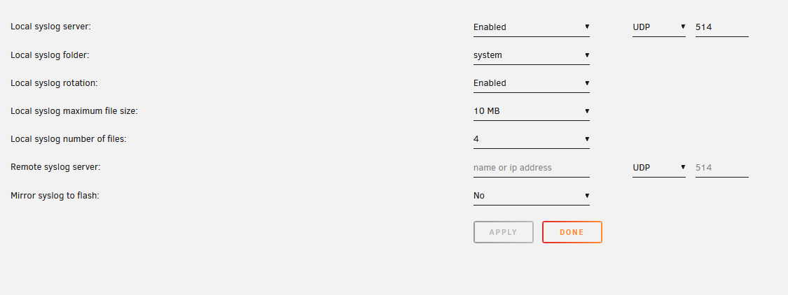

August 28, 20233 yr Author thanks, i'll try that. enabled the syslog but nothing in system share, doing something wrong?
August 28, 20233 yr Community Expert You set it to listen waiting for log entries to be sent to it! As mentioned in the link you need to get entries from the server hosting the Syslog Server you need to either put the servers address into the remote syslog field or set mirror to flash.
August 29, 20233 yr Author just changed that and it's now ok, thanks my second server crashed this morning. is it me or are we many to have server crash without reason in the last months? I personnaly never had issues and on day both started crashing at a rate of every 10-15 days, sometimes a bit more...
September 12, 20233 yr Author server crashed again 😞 nostromo-diagnostics-20230912-1624.zip syslog-192.168.1.80.log
September 12, 20233 yr Community Expert Sep 9 22:07:01 Nostromo kernel: macvlan_broadcast+0x10a/0x150 [macvlan] Sep 9 22:07:01 Nostromo kernel: ? _raw_spin_unlock+0x14/0x29 Sep 9 22:07:01 Nostromo kernel: macvlan_process_broadcast+0xbc/0x12f [macvlan] Switching to ipvlan should fix it (Settings -> Docker Settings -> Docker custom network type -> ipvlan (advanced view must be enabled, top right)).
