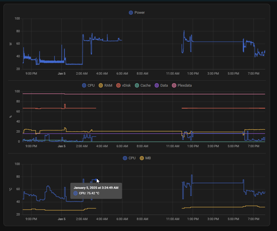

January 5, 20251 yr This morning the server was unresponsive on the web UI. I tried to login locally, which was very laggy and ended up with "login: timed out after 60 seconds" after entering the username, exact behavior as mentioned in following post: Because of these stability issues and recent checksum issues I ran a memtest after a reboot which failed when using 2*16GB, tried either RAM stick 1x16GB in either slot when running memtest, both slots/sticks failed. Both memory sticks started failing somehow in the last month. Strange as this memory was working fine in the same system running windows prior to using unraid. I performed a memtest after deciding to go with ZFS, which passed mid december. This system ran fine for 2 years. Either way I purchased a new 1x32GB and no memtest errors. I will keep monitoring, and hope faulty memory caused the issues I experienced. I did notice the CPU was getting quite hot due to some scheduled maintenance/backup tasks between 2 to 3:25 AM, which I believe is when unraid got stuck, HA (running on unraid) did keep collecting data from the external power monitor, but no longer from unraid, until I suppose docker even got stuck, ending any data stored after 6 AM. I've changed my fan settings to keep the CPU temp lower under full load, and also improved ventilation so that the memory / cache drives run less hot. Hoping these changes will solve the issues with system instability Edited January 5, 20251 yr by hhhhh
