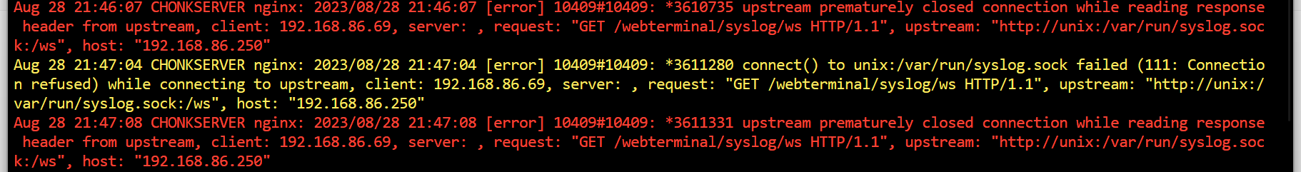

I have a weird issue where my Macbook Pro is not able to connect to the unraid terminal, the screen is just stuck on reconnecting. I can use the WebUI but the terminal and syslog does not open. Works fine on all my other devices (different browsers and OS). I've tried a lot to troubleshoot this but not sure where to go next.

Originally noticed the issue on Firefox but also happening on Safari and Chrome. I've reset and clear cookies and cache on Firefox but no luck. I tested yesterday enabling SSL cert in Management access settings and the issue went away!  But it broke my Cloudflare tunnel to my server. So ideally i don't want to use SSL certs. Anything else I can try?
I don't use MacOS, but if it happens with different browsers possibly an OS issue.
Thanks @JorgeB I'll try re-imaging my laptop.
Re-imaging my Macbook seemed to fix the issue! For anyone else encountering this issue. Take a time machine back up then re-imaging is very simple.
