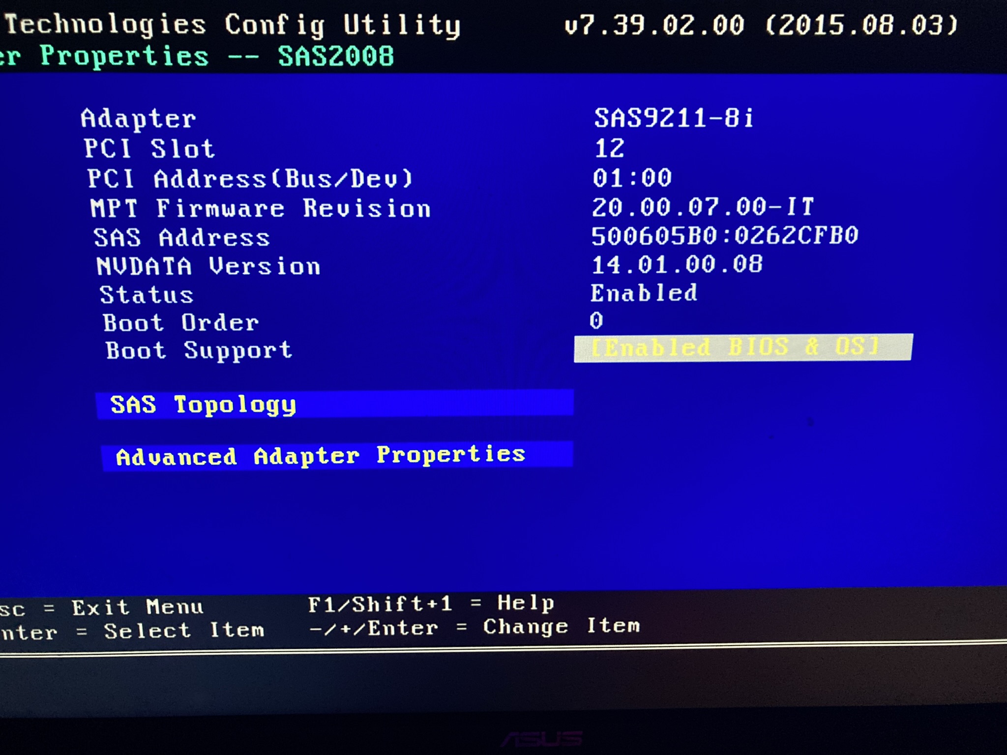

I have an IBM M1015 reflashed into an LSI/Avago SAS9211-8i in IT mode with FW version 20.00.07.00-IT.

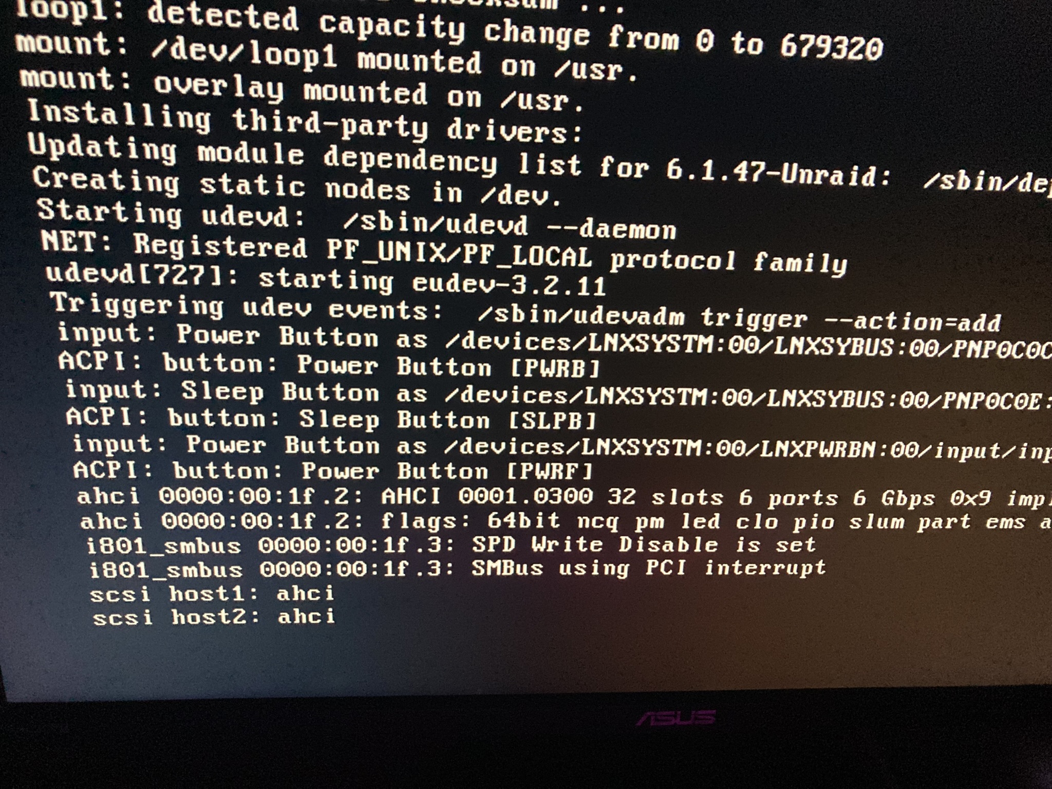

I tried booting legacy and UEFI and it always get stuck near those messages,

Here are some screenshots : Images on Imgur

Does it boot without the HBA? Also try a different PCIe slot if possible.
I was expecting it to be the PCIe card but no, same issue with the card out...
This led me to start removing things one by one and finally I found it.
I have a few old SSD that I plugged to hopefully use and one of them seem to be causing it.
Once I removed it, it booting right up, I will try to find out why one SSD can cause that, might be corrupt or weird partition might be left on it.
Thank you for questioning the obvious, this led me on the right path.
