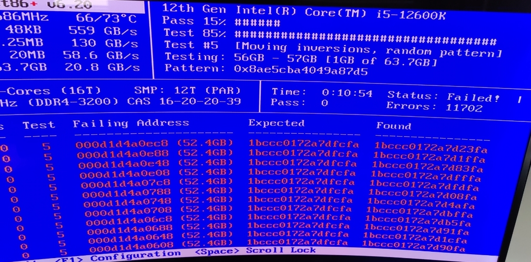

Hi, I run memtest grom USB and at start I got many errors. Do I have to buy new RAM?
Yep.
You could try setting the RAM to a slower clock speed to see if that helps.
If you have multiple RAM sticks you could try testing them individually.
Even 1 error is too many when testing the RAM.

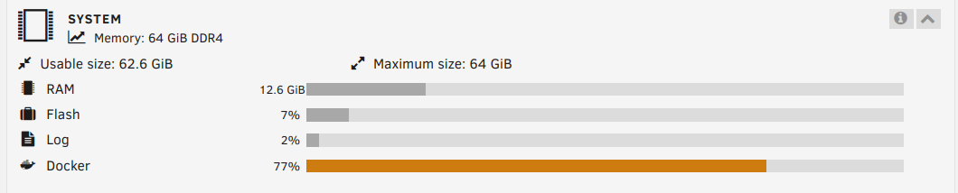

Hello, I add new 2 x 32GB RAM and format ssd cache to XFS. Now I don't have docker fails error but I get notifications that docker utilisation grows. Now is:image.png.834124d7ea8b6c7bd5bea184fad8c2a8.png
I set docker image to 30GB. Now it's 32,2GB.
In main dashboard I see:

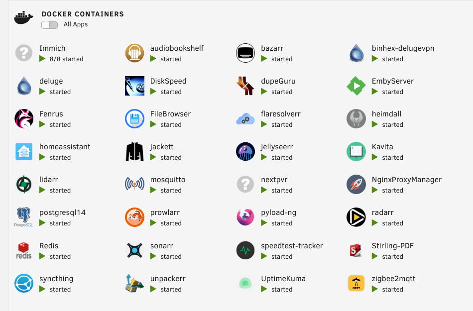

What can I do with that?
It's because i have many apps installed?

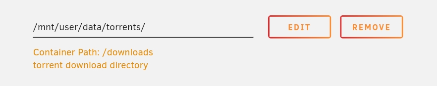

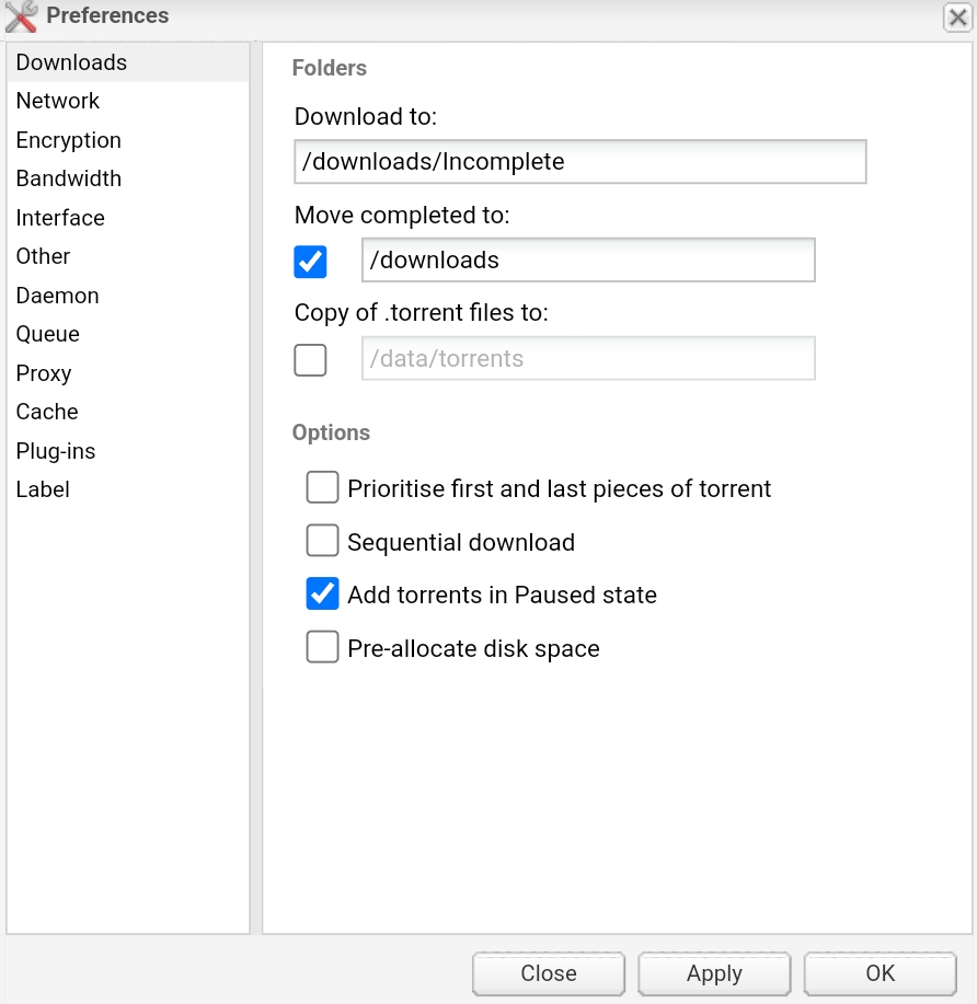

1 hour ago, JorgeB said:
Hi, I think my both deluge and deluge-vpn I use for downloading have wright paths now. I set that incomplete folder in deluge web UI before I format and delete docker.img (there was about 100gb).
I see both download to Incomplete folder as it set.

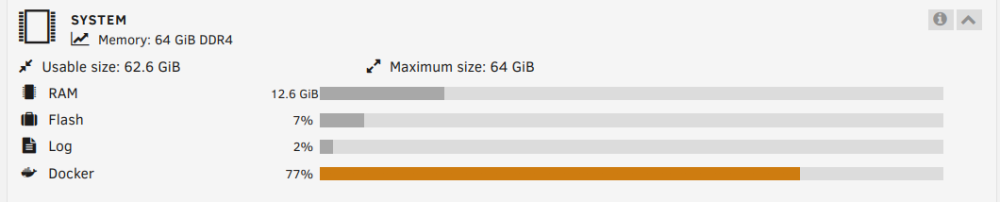

Hi, @JorgeB can You tell me one more thing? I format my cache sdd, recrete docker.img and now have only 48%, docker set to 30GB. Don't occure docker errors so far.
