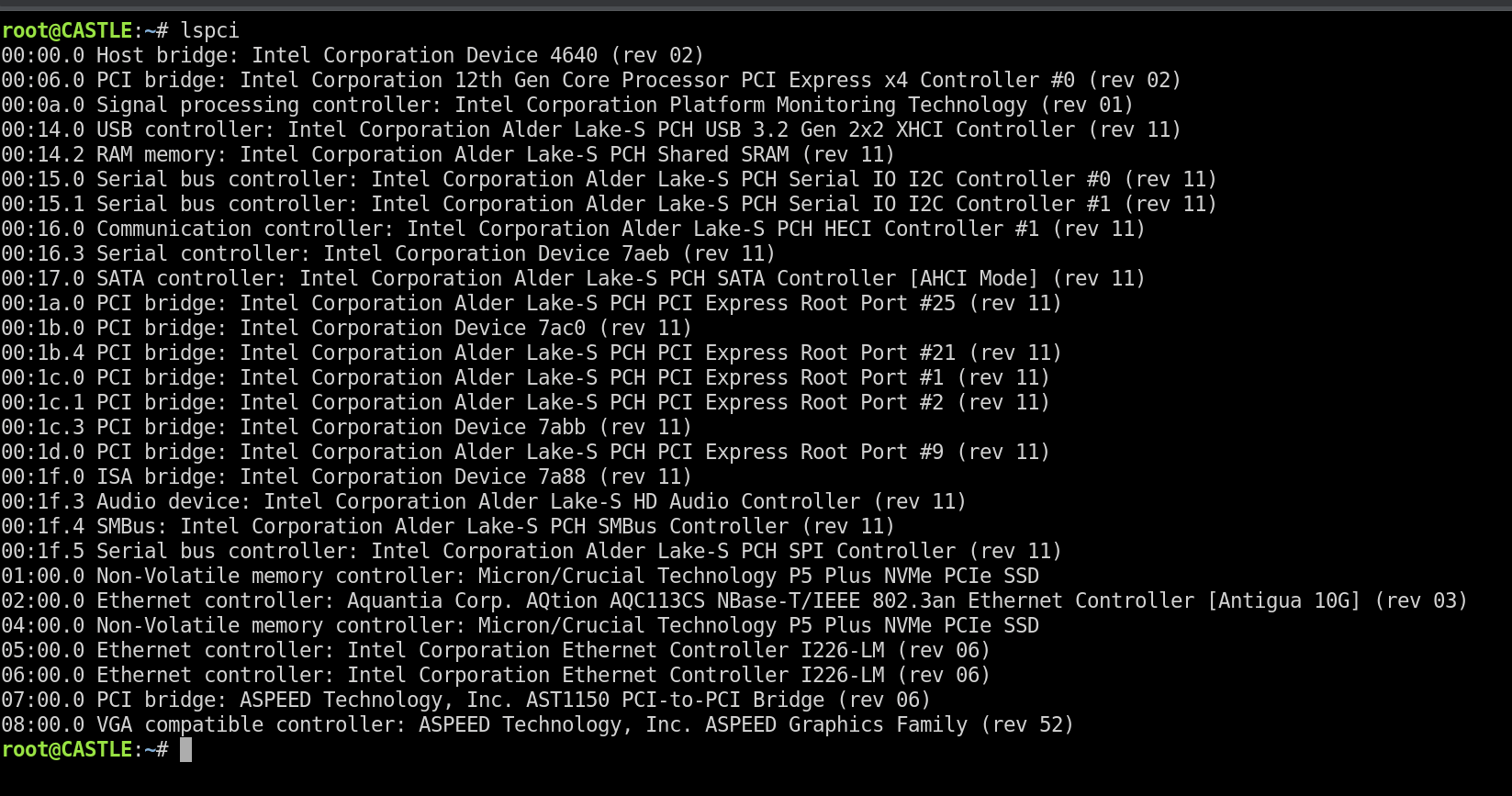

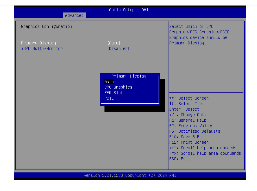

August 12, 20242 yr 21 hours ago, SimonF said: Have you enabled in bios? post diagnostics? Here is my BIOS options, see attached image. I send diagnostic in a few. I only see an enable option for multi-monitor and the primary display is set to Auto. Motherboard: Asus Pro WS W680M-ACE SE BIOS: 3107 Processor: 13th Gen Intel(R) Core(TM) i5-13500T
August 12, 20242 yr Community Expert 3 minutes ago, Ben4 said: Here is my BIOS options, see attached image. I send diagnostic in a few. I only see an enable option for multi-monitor and the primary display is set to Auto. Motherboard: Asus Pro WS W680M-ACE SE BIOS: 3107 Processor: 13th Gen Intel(R) Core(TM) i5-13500T Try cpu also do you have a physical gpu in system or just igpu?

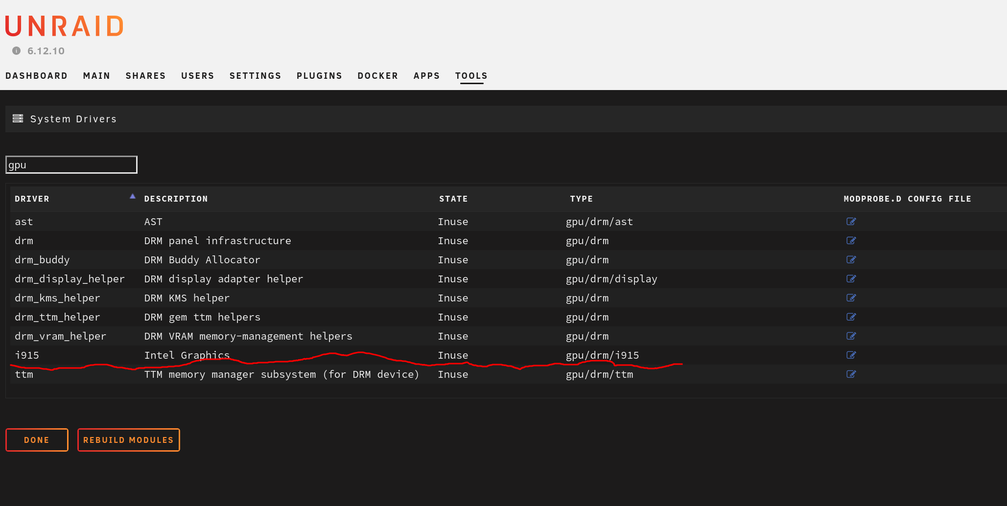

August 12, 20242 yr 2 hours ago, SimonF said: Try cpu also do you have a physical gpu in system or just igpu? No physical gpu. I will try cpu. Also, when I go to system drivers in unraid and search for gpu, i see the intel i915 inuse. See screenshot.
August 12, 20242 yr Community Expert 2 minutes ago, Ben4 said: No physical gpu. I will try cpu. Also, when I go to system drivers in unraid and search for gpu, i see the intel i915 inuse. See screenshot. does gpu show in lspci?

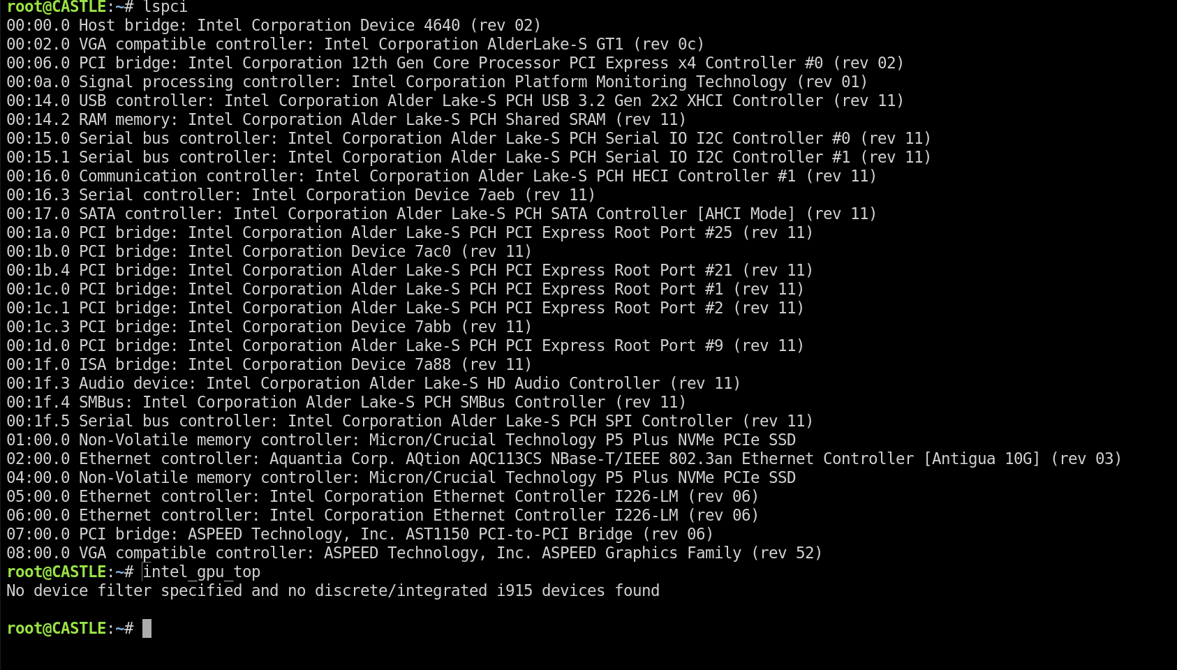

August 12, 20242 yr 34 minutes ago, SimonF said: does gpu show in lspci? I don't see it. actually would it be the ASPEED Graphics? I thought that was for my BMC? Edited August 12, 20242 yr by Ben4
August 12, 20242 yr Community Expert 6 minutes ago, Ben4 said: I don't see it. actually would it be the ASPEED Graphics? I thought that was for my BMC? Would normally show as 00:02.0 for igpu. aspeed is going to be bmc.
August 12, 20242 yr Community Expert IOMMU group 0:[8086:4680] 00:02.0 VGA compatible controller: Intel Corporation AlderLake-S GT1 (rev 0c) IOMMU group 1:[8086:4648] 00:00.0 Host bridge: Intel Corporation Device 4648 (rev 02) IOMMU group 2:[8086:460d] 00:01.0 PCI bridge: Intel Corporation 12th Gen Core Processor PCI Express x16 Controller #1 (rev 02) IOMMU group 3:[8086:464d] 00:06.0 PCI bridge: Intel Corporation 12th Gen Core Processor PCI Express x4 Controller #0 (rev 02) IOMMU group 4:[8086:464f] 00:08.0 System peripheral: Intel Corporation 12th
August 12, 20242 yr Community Expert 14 minutes ago, Ben4 said: I don't see it. actually would it be the ASPEED Graphics? I thought that was for my BMC? Have a look at this tread I think you need to enable multi monitor.
August 12, 20242 yr 34 minutes ago, SimonF said: Have a look at this tread I think you need to enable multi monitor. I've enabled iGPU multi-monitor and changed the display in the BIOS from Auto to CPU. I can now see the iGPU. I still don't get any results when I run the intel_gpu_top command. I also unplugged my monitor just to be safe. See screenshot Edited August 12, 20242 yr by Ben4
