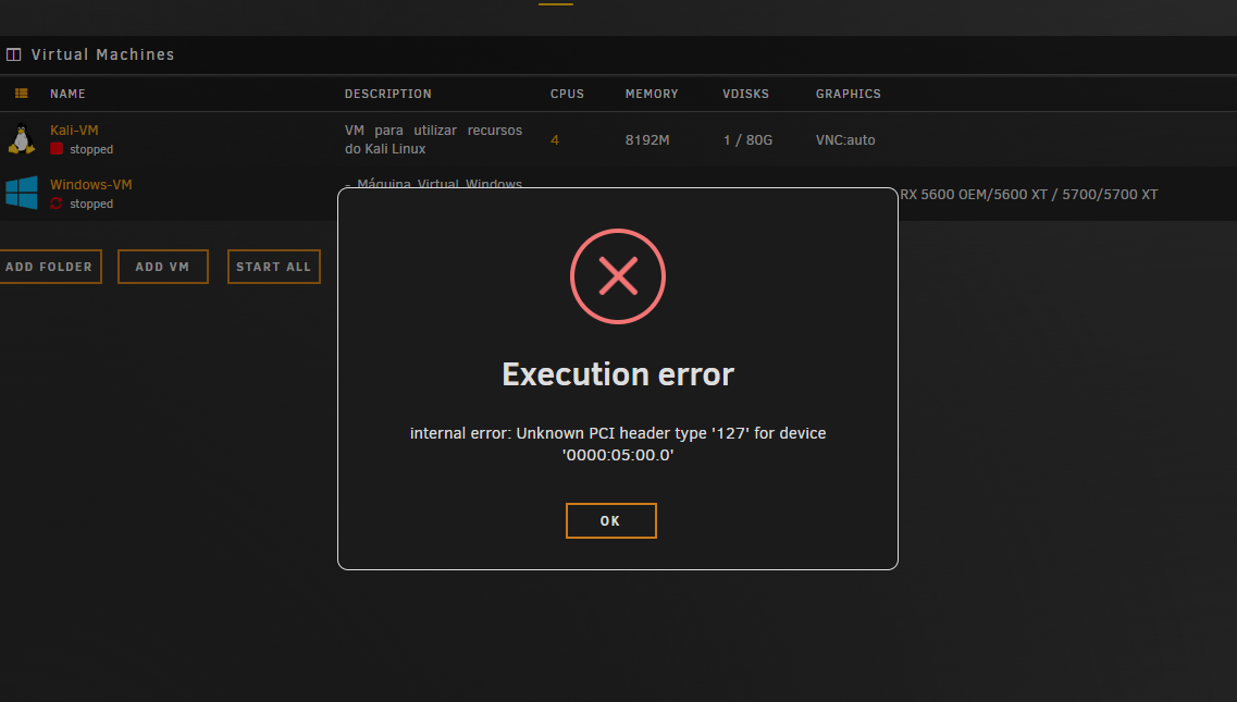

The Error:

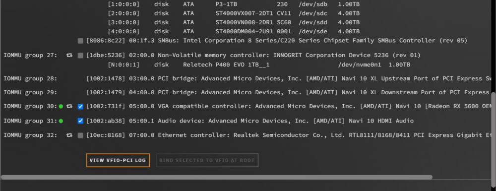

System Devices:

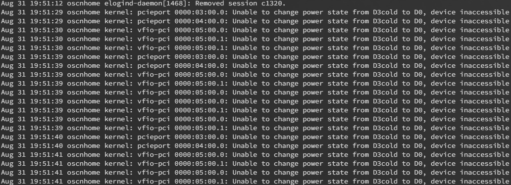

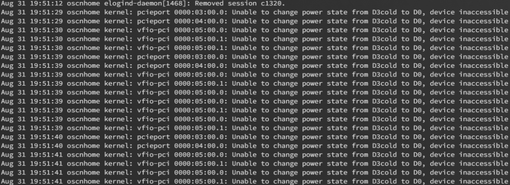

Some interesting log:

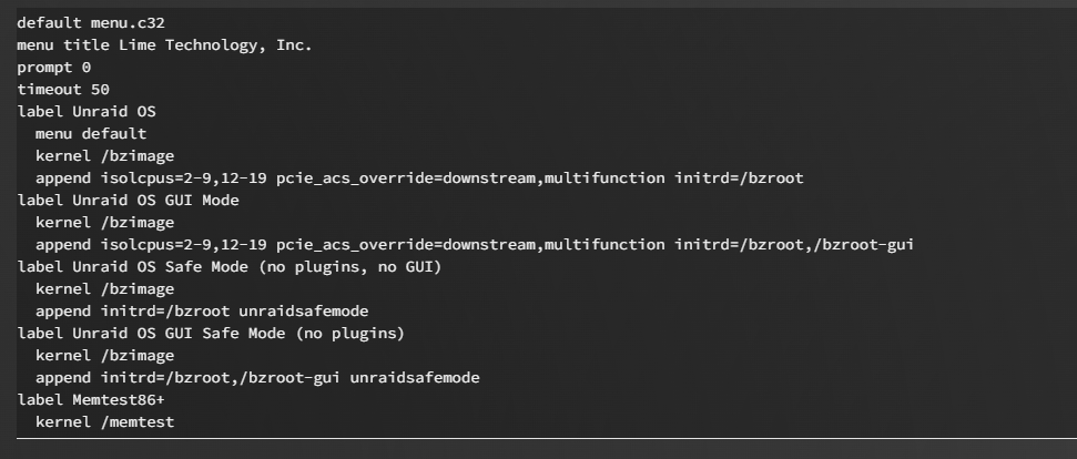

Syslinux Configuration:

Solved by oscnhome
Ok, i realized that was an hardware error. It's ok now.
