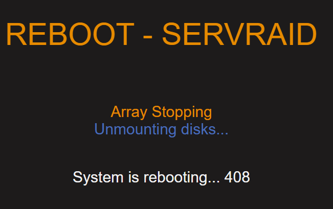

September 25, 2025Sep 25 So I just did a manual reboot from GUI. Right before, I ran a diagnostic just to be sure that diagnostic would finish. Well guess what, it's stuck.I can SSH in it no problem.syslog show it did a diagnostic, failed and tried to start nginx back (Why?) and then it's stucksyslog.txtedit: I tried calling a shutdown -r now, I lost my ssh session and cannot open a new one. 10 minutes have passed, I can still ping but that's it. I had to force shutdown. It's not normal. All docker where shutdown and vm also (I've checked with ssh and syslog shows it). I can't realy on something that cannot be shutdown when UPS is running, it's absurd servraid-diagnostics-20250924-2145.zip Edited September 25, 2025Sep 25 by Nodiaque
September 25, 2025Sep 25 1 hour ago, JorgeB said:You'll need to force a reboot.Whilst that seems to be the only solution which you repeat each time, it's not ideal. The problem is that if you reboot it, the next time it shuts down fine. It really should have some form of timeout on these processes rather than hanging there forever. There's not really anything logged to the screen to determined exactly what it's waiting on or anything. Perhaps it's because the logs are large but it shouldn't take 15 minutes or more.Edit: I can't even find where the "Starting diagnostics collection..." string even comes from. Seems a bit more than just a simple shutdown script but even grepping through the binaries I'm not seeing it. Edited September 25, 2025Sep 25 by Shonky
September 25, 2025Sep 25 4 hours ago, JorgeB said:You'll need to force a reboot.That's what I did. The question is why do I need it. This time if you look at log, it doesn't even to have stuck at the unneeded diagnostic. That server was restarted like 4 days before without any problem. I was restarting this time because of nvidia driver update. And that happen. This make the solution very unreliable in case of emergency shutdown because of UPS (happened more then once that the server died because UPS battery was dead waiting for the server to close more then 30 minutes). Something is needed to prevent this issue. I never saw an issue on shutdown on any unix system. I've uploaded the logs I could give, if something else is needed I'll give it.edit: unsure if you check the syslog. But everything stopped promptly. All service stopped, all docker, vm, network connection, all disk where unmounted. But thenSep 24 21:14:31 #### root: Capture diagnostics to /boot/logs Sep 24 21:14:31 #### publish: curl to diagnostics failed Sep 24 21:14:31 #### publish: curl to diagnostics failed Sep 24 21:14:31 #### publish: curl to diagnostics failed (repeating infinitly) Sep 24 21:14:32 #### kernel: XFS (nvme2n1p1): Unmounting Filesystem 0dc5511c-9b2f-46cc-bfa6-de412b4769e0 Sep 24 21:14:31 #### publish: curl to diagnostics failed (repeating infinitly)Why a diagnostic, everything shutdown properly.And then, it try to kill nginx and crashSep 24 21:14:36 #### rc.nginx: Stopping Nginx server daemon forcibly... Sep 24 21:14:36 #### rc.nginx: Nginx server daemon... Already stopped. Sep 24 21:14:39 #### kernel: BUG: unable to handle page fault for address: ffffffffa7466458 Sep 24 21:14:39 #### kernel: #PF: supervisor read access in kernel mode Sep 24 21:14:39 #### kernel: #PF: error_code(0x0000) - not-present page Sep 24 21:14:39 #### kernel: PGD 541a067 P4D 541a067 PUD 541b063 PMD 10a506067 PTE 0 Sep 24 21:14:39 #### kernel: Oops: Oops: 0000 [#1] PREEMPT SMP NOPTI Sep 24 21:14:39 #### kernel: CPU: 0 UID: 0 PID: 1445014 Comm: btrfs Tainted: P O 6.12.24-Unraid #1 Sep 24 21:14:39 #### kernel: Tainted: [P]=PROPRIETARY_MODULE, [O]=OOT_MODULE Sep 24 21:14:39 #### kernel: Hardware name: Dell Inc. Precision 5820 Tower/06JWJY, BIOS 2.11.0 09/30/2021 Sep 24 21:14:39 #### kernel: RIP: 0010:bdev_open+0x8e/0x300 Sep 24 21:14:39 #### kernel: Code: 00 48 89 c7 48 89 44 24 08 e8 ae d3 59 00 49 8b 46 40 48 83 b8 80 04 00 00 00 75 0a b8 fa ff ff ff e9 35 02 00 00 49 8b 46 48 <48> 8b 78 78 e8 09 bd b7 ff 84 c0 41 89 c7 74 e2 80 3d 23 35 fb 00 Sep 24 21:14:39 #### kernel: RSP: 0018:ffffc90001f23c38 EFLAGS: 00010282 Sep 24 21:14:39 #### kernel: RAX: ffffffffa74663e0 RBX: ffff888107518c80 RCX: 0000000000000000 Sep 24 21:14:39 #### kernel: RDX: ffff88844828dd00 RSI: 0000000000000009 RDI: ffff88810a6929f8 Sep 24 21:14:39 #### kernel: RBP: 0000000000000009 R08: ffff88826b30ca80 R09: 0000000000000009 Sep 24 21:14:39 #### kernel: R10: 0000000000000f01 R11: fefefefefefefe01 R12: ffff88826b30ca80 Sep 24 21:14:39 #### kernel: R13: 0000000000000000 R14: ffff88810a692800 R15: 0000000000000000 Sep 24 21:14:39 #### kernel: FS: 0000152b0e43f900(0000) GS:ffff88a01fa00000(0000) knlGS:0000000000000000 Sep 24 21:14:39 #### kernel: CS: 0010 DS: 0000 ES: 0000 CR0: 0000000080050033 Sep 24 21:14:39 #### kernel: CR2: ffffffffa7466458 CR3: 0000000139e32002 CR4: 00000000003706f0 Sep 24 21:14:39 #### kernel: DR0: 0000000000000000 DR1: 0000000000000000 DR2: 0000000000000000 Sep 24 21:14:39 #### kernel: DR3: 0000000000000000 DR6: 00000000fffe0ff0 DR7: 0000000000000400 Sep 24 21:14:39 #### kernel: Call Trace: Sep 24 21:14:39 #### kernel: <TASK> Sep 24 21:14:39 #### kernel: ? iput+0x64/0x1a0 Sep 24 21:14:39 #### kernel: ? __pfx_blkdev_open+0x10/0x10 Sep 24 21:14:39 #### kernel: blkdev_open+0x96/0xc0 Sep 24 21:14:39 #### kernel: do_dentry_open+0x1ae/0x330 Sep 24 21:14:39 #### kernel: vfs_open+0x27/0x50 Sep 24 21:14:39 #### kernel: path_openat+0x8e8/0x9f0 Sep 24 21:14:39 #### kernel: ? terminate_walk+0x1d/0x70 Sep 24 21:14:39 #### kernel: do_filp_open+0xa4/0x110 Sep 24 21:14:39 #### kernel: ? __pfx_kfree_link+0x10/0x10 Sep 24 21:14:39 #### kernel: ? kmem_cache_debug_flags+0xc/0x20 Sep 24 21:14:39 #### kernel: ? rawspin_unlock+0x14/0x30 Sep 24 21:14:39 #### kernel: do_sys_openat2+0x6d/0xc0 Sep 24 21:14:39 #### kernel: do_sys_open+0x3a/0x60 Sep 24 21:14:39 #### kernel: do_syscall_64+0x68/0xe0 Sep 24 21:14:39 #### kernel: entry_SYSCALL_64_after_hwframe+0x76/0x7e Sep 24 21:14:39 #### kernel: RIP: 0033:0x152b0e4d95c7 Sep 24 21:14:39 #### kernel: Code: 46 b8 04 00 00 00 48 8b 15 1e 78 16 00 64 89 02 48 c7 c2 ff ff ff ff 5b 48 89 d0 c3 0f 1f 80 00 00 00 00 48 8b 44 24 10 0f 05 <48> 63 d0 3d 00 f0 ff ff 77 0f 48 89 d0 5b c3 66 2e 0f 1f 84 00 00 Sep 24 21:14:39 #### kernel: RSP: 002b:00007ffefba98510 EFLAGS: 00000202 ORIG_RAX: 0000000000000101 Sep 24 21:14:39 #### kernel: RAX: ffffffffffffffda RBX: 0000152b0e43f900 RCX: 0000152b0e4d95c7 Sep 24 21:14:39 #### kernel: RDX: 0000000000080800 RSI: 0000000000521ec0 RDI: ffffffffffffff9c Sep 24 21:14:39 #### kernel: RBP: 0000000000520430 R08: 0000000000000000 R09: 0000000000000000 Sep 24 21:14:39 #### kernel: R10: 0000000000000000 R11: 0000000000000202 R12: 0000000068d4977f Sep 24 21:14:39 #### kernel: R13: 0000000068d4976c R14: 0000152b0e82aa9c R15: 0000000000000013 Sep 24 21:14:39 #### kernel: </TASK> Sep 24 21:14:39 #### kernel: Modules linked in: nft_compat tls cmac cifs cifs_arc4 nls_ucs2_utils cifs_md4 dns_resolver af_packet bluetooth rfkill xt_CHECKSUM ipt_REJECT nf_reject_ipv4 ip6table_mangle iptable_mangle vhost_iotlb nft_m asq nft_chain_nat nvidia_uvm(PO) veth nf_conntrack_netlink xt_nat xt_conntrack bridge xfrm_user xt_addrtype xt_MASQUERADE xt_tcpudp xt_mark tun nf_tables nfnetlink ip6table_nat iptable_nat nf_nat nf_conntrack nf_defrag_ipv6 nf_defrag_ipv 4 ntfs3 tcp_diag inet_diag zfs(PO) spl(O) ip6table_filter ip6_tables iptable_filter ip_tables x_tables efivarfs macvtap macvlan tap 8021q garp mrp stp llc ixgbe xfrm_algo mdio e1000e nvidia_drm(PO) nvidia_modeset(PO) intel_rapl_common io sf_mbi nvidia(PO) x86_pkg_temp_thermal intel_powerclamp coretemp drm_ttm_helper ttm video drm_kms_helper drm crct10dif_pclmul crc32_pclmul crc32c_intel ghash_clmulni_intel sha512_ssse3 sha256_ssse3 sha1_ssse3 aesni_intel crypto_simd cryp td rapl i2c_i801 backlight intel_cstate input_leds intel_wmi_thunderbolt wmi_bmof dell_smm_hwmon Sep 24 21:14:39 #### kernel: intel_uncore led_class tpm_crb mpt3sas nvme agpgart i2c_smbus mei_me raid_class nvme_core scsi_transport_sas i2c_core ahci mei vmd tpm_tis libahci tpm_tis_core wmi tpm libaescfb ecdh_generic ecc acpi_tad button [last unloaded: md_mod] Sep 24 21:14:39 #### kernel: CR2: ffffffffa7466458 Sep 24 21:14:39 #### kernel: ---[ end trace 0000000000000000 ]--- Sep 24 21:14:39 #### kernel: pstore: backend (erst) writing error (-28) Sep 24 21:14:39 #### kernel: RIP: 0010:bdev_open+0x8e/0x300 Sep 24 21:14:39 #### kernel: Code: 00 48 89 c7 48 89 44 24 08 e8 ae d3 59 00 49 8b 46 40 48 83 b8 80 04 00 00 00 75 0a b8 fa ff ff ff e9 35 02 00 00 49 8b 46 48 <48> 8b 78 78 e8 09 bd b7 ff 84 c0 41 89 c7 74 e2 80 3d 23 35 fb 00 Sep 24 21:14:39 #### kernel: RSP: 0018:ffffc90001f23c38 EFLAGS: 00010282 Sep 24 21:14:39 #### kernel: RAX: ffffffffa74663e0 RBX: ffff888107518c80 RCX: 0000000000000000 Sep 24 21:14:39 #### kernel: RDX: ffff88844828dd00 RSI: 0000000000000009 RDI: ffff88810a6929f8 Sep 24 21:14:39 #### kernel: RBP: 0000000000000009 R08: ffff88826b30ca80 R09: 0000000000000009 Sep 24 21:14:39 #### kernel: R10: 0000000000000f01 R11: fefefefefefefe01 R12: ffff88826b30ca80 Sep 24 21:14:39 #### kernel: R13: 0000000000000000 R14: ffff88810a692800 R15: 0000000000000000 Sep 24 21:14:39 #### kernel: FS: 0000152b0e43f900(0000) GS:ffff88a01fa00000(0000) knlGS:0000000000000000 Sep 24 21:14:39 #### kernel: CS: 0010 DS: 0000 ES: 0000 CR0: 0000000080050033 Sep 24 21:14:39 #### kernel: CR2: ffffffffa7466458 CR3: 0000000139e32002 CR4: 00000000003706f0 Sep 24 21:14:39 #### kernel: DR0: 0000000000000000 DR1: 0000000000000000 DR2: 0000000000000000 Sep 24 21:14:39 #### kernel: DR3: 0000000000000000 DR6: 00000000fffe0ff0 DR7: 0000000000000400 Sep 24 21:14:39 #### kernel: note: btrfs[1445014] exited with irqs disabledAnd then that curl error about diagnostics again and... it start nginx back?????Sep 24 21:14:39 #### publish: curl to diagnostics failed Sep 24 21:14:39 #### publish: curl to diagnostics failed Sep 24 21:14:39 #### publish: curl to diagnostics failed Sep 24 21:14:41 #### rc.nginx: Starting Nginx server daemon... Sep 24 21:14:42 #### rc.nginx: Nginx server daemon... Started.It's not normal. Honestly, that diagnostic on shutdown is good for nothing, specially in case of emergency reboot. Someone needing to shutdown because of battery low could have a server crash just because it decided to ran a diagnostic nobody will check. Edited September 25, 2025Sep 25 by Nodiaque
