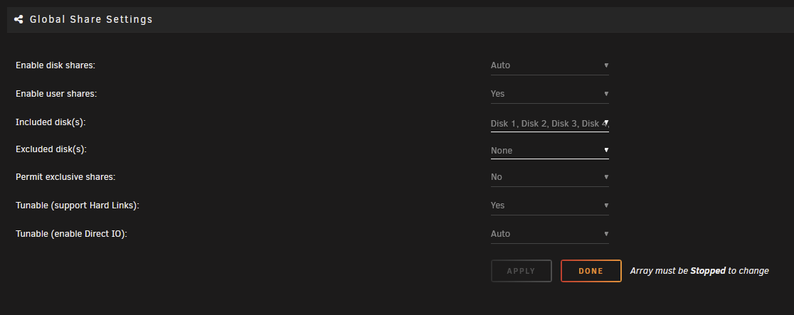

September 2, 20233 yr Hi, I've had this error in my "Fix Common Problems" scan for quite some time. I can't see an obvious solution (despite searching) and it doesn't *seem* to impact my everyday server function so I've ignored up until now (I'm trying to square away any remaining niggles). I get the following error regarding Global Shares.... However, when I go to the Global Shares setting, you can see that there is no disks listed in "Exclude" and all the Array disks are listed in "Include"... Any ideas? Thanks in advance, R tower-diagnostics-20230902-1034.zip Edited September 2, 20233 yr by rich110 upload Diag. Logs
September 2, 20233 yr Community Expert Solution There's no disk8 now, but it's still set to exclude it, it's not a problem now, but it can be if you add a disk8 in the future, you can edit /boot/config/shares.cfg and change shareUserExclude="disk8" to shareUserExclude="".
