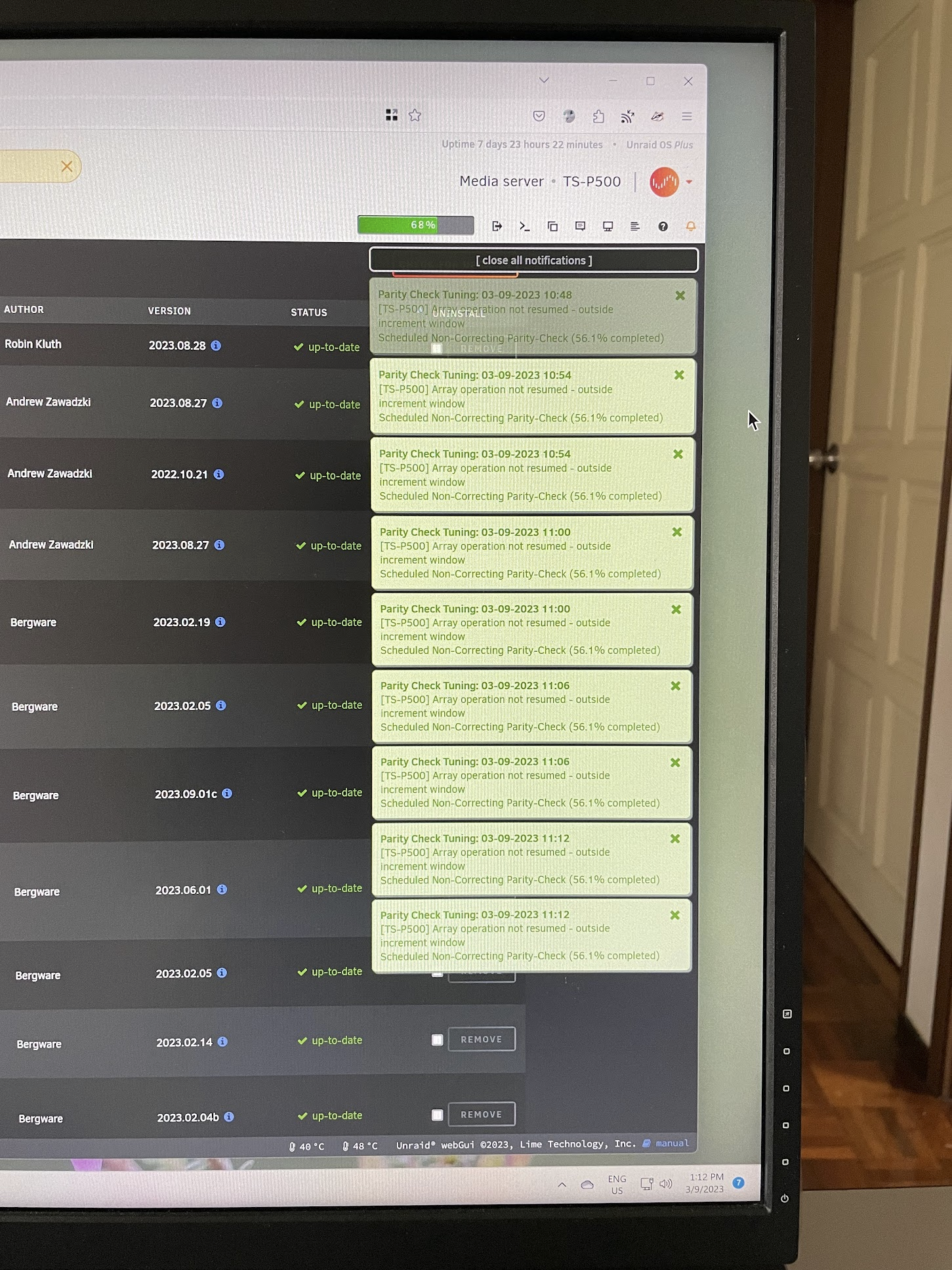

Dear All,
Just recently my server just send SNMP nonstop on the same event.
Its been working well until recent before that just 1 notification on 1 event only but this few day it just keep sending the same SNMP for the same event repeatably nonstop.

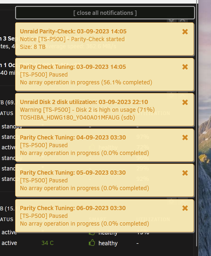

After reboot i tot its fix. but seems it still do broadcast. I dont behave at such until last week onward.
ts-p500-diagnostics-20230906-1421.zip
Make sure you are on the latest release of the parity.check.tuning plugin.
If you have it delete the 'parity.check.tuning.paused' file in the plugins folder on the flash drive. Looks like the plugin somehow has missed the fact the check has finished in your case although the latest version may fix this.
If you continue to have problems after that then please enable the 'Testing' mode logging in the plugins settings and post your diagnostics after the problem has occurred so I can check out why.

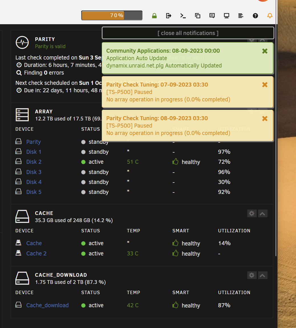

Ok im still getting the SNMP notification at 3.30am each day even there suppose to be no event. Ive attach the Diagnostic log with Testing mode logging enable.

Delete the 'parity.tuning.restart' and 'parity.tuning.scheduled' files from the plugins folder - it looks like this is left over from the previous issue!   They would probably have been automatically tidied up if you had rebooted but it looks like this did not happen?
