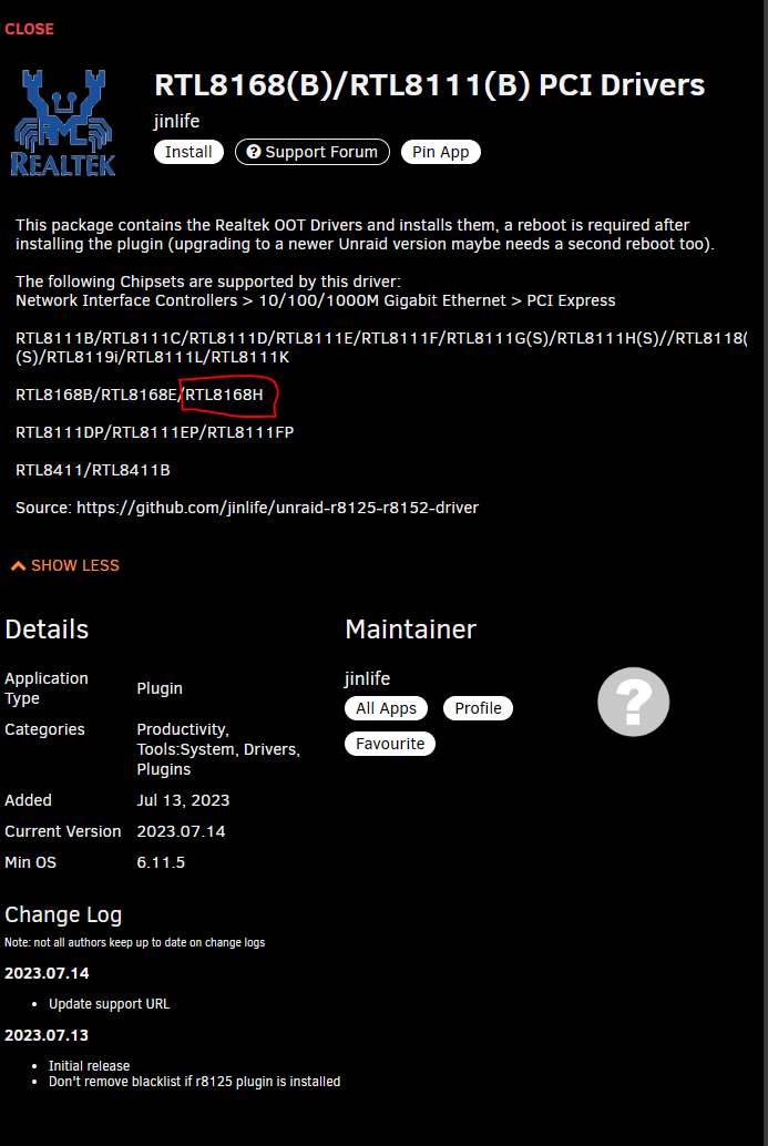

Look for an RTL8156 based USB NIC and install this plugin:
I see there's also an RTL8168 drive in the plugin, so try that one first.
Installing the plugin appears to require internet access (and my problem is I have no internet access). I'm looking through the .plg file to see if I can manually place the necessary files where they need to go.
My main machine is windows, and I don't think I can access the necessary folders (/boot/config/plugins/ to place the files where they should go on the windows machine). Creating the folders on the root of the USB Drive seems to be treated as /boot/boot/... on the unraid machine.
This process makes me think I'm doing something incorrectly. How should I install a plugin without internet access?
