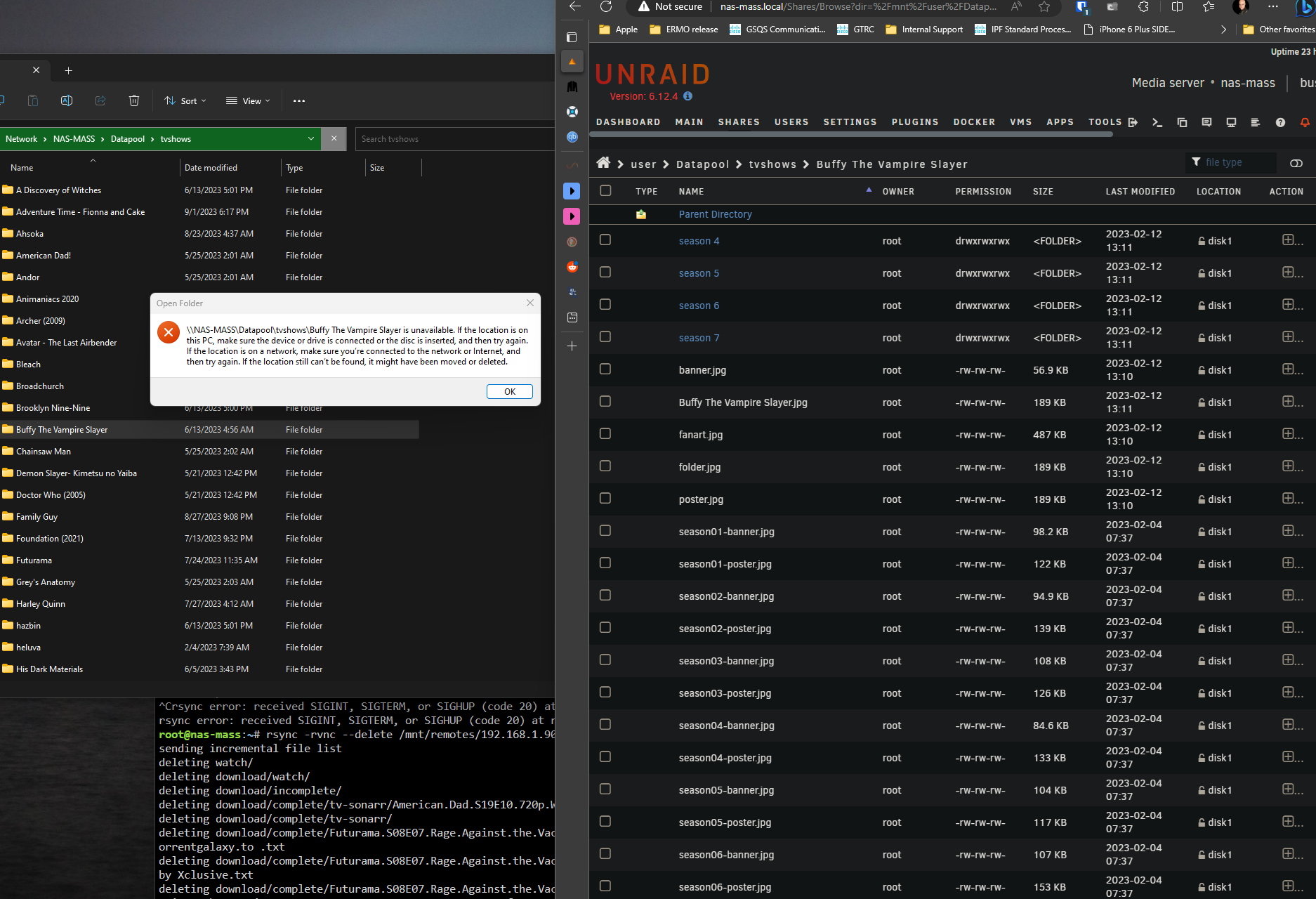

Can't open sub folder in share from windows 11 or anywhere else after rsyn'ing data
I have bunch of data I copied over from an old nas.
Whenever I try open on those folders I get weird windows pop up saying the location in unavailable. I can brows to it fine via the unraid UI with no problem and everything looks intact. Other, non imported files and folders seem fine.
Screen shot showing exact message attached.
"[Window Title]
Open Folder
[Content]
\\NAS-MASS\Datapool\tvshows\Buffy The Vampire Slayer is unavailable. If the location is on this PC, make sure the device or drive is connected or the disc is inserted, and then try again. If the location is on a network, make sure you’re connected to the network or Internet, and then try again. If the location still can’t be found, it might have been moved or deleted.
[OK]"
Edited by Bushibot
clarified title

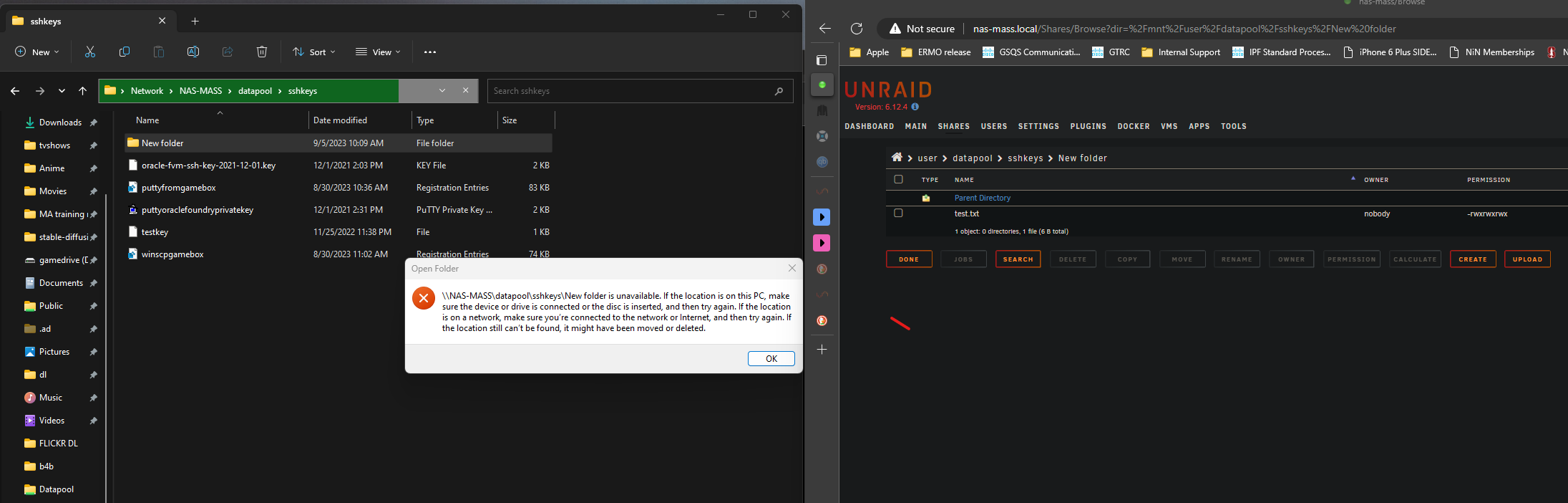

I did a simple rsync of 1 folder with 1 subfolder.
rsync -azh --progress /mnt/remotes/192.168.1.90_Public/sshkeys /mnt/user/datapool/
The top level folder is fine, the lower level folder throws the same exact error when I try to open it.

So a little more on this. I thought it was only related to migrated data, but this is not the case. It's popping up all over with new folders now created through containers.
What I have found is it seems related ownership.
I can't access from windows/mac sub folders owned by nobody. I can access top level shares though and they are owned by nobody.
I can access folders owned by root or griffon from windows/mac.
 Can't access windows/mac: drwsrwsrwt 1 nobody users 74 Sep 10 12:10 folder1/
Can access: drwsrwsrwt 1 griffon users 160 Sep  7 02:30 folder2/
Can access: drwxr-xr-x 1 root root 4096 Sep  8 23:43 folder 3/
I thought ok let me just change the ownership... but that didn't fix it either, folders taken by root still remain inaccessible right next to ones that are.
