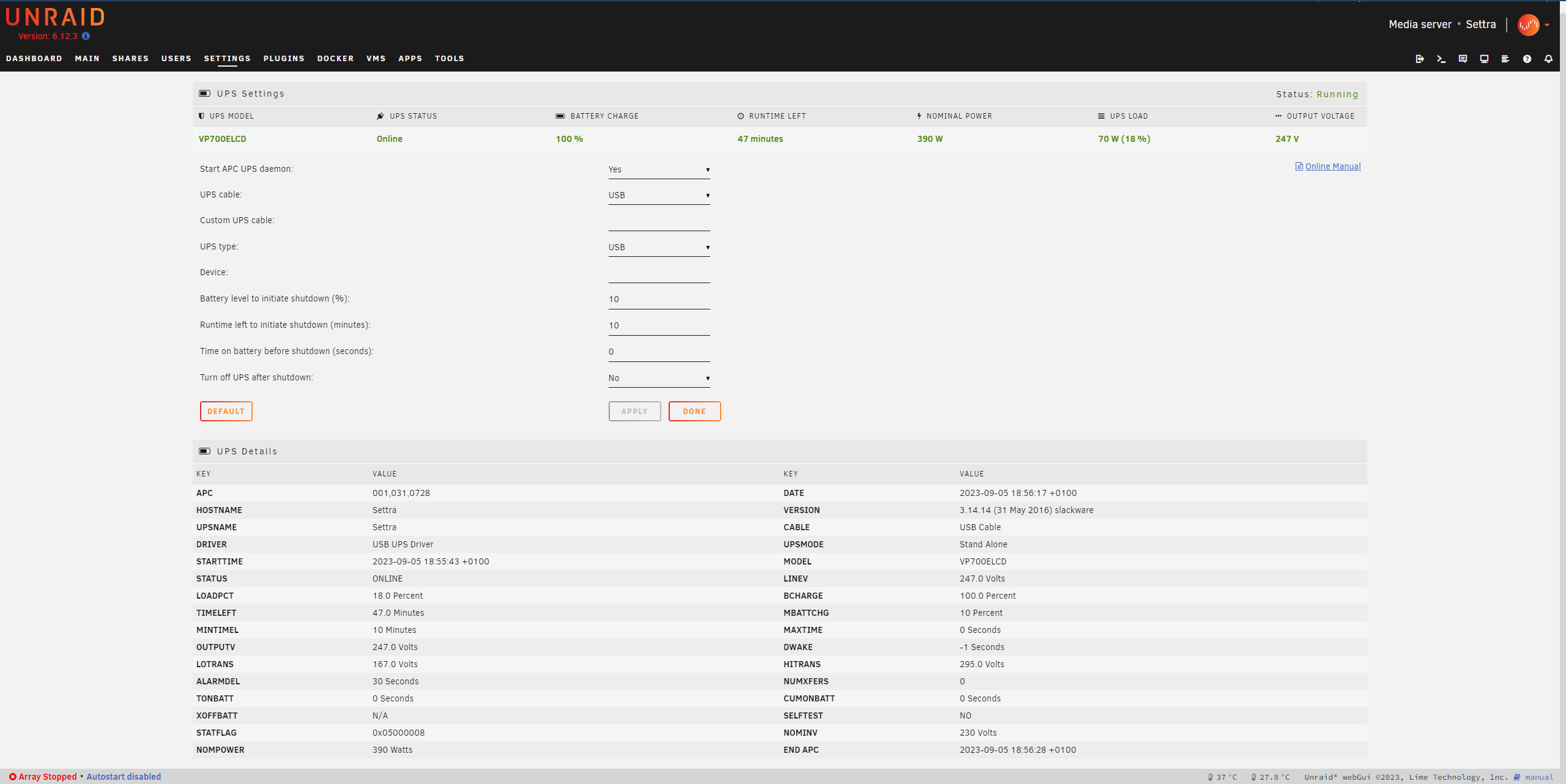

I've recently transferred from a Synology NAS to Unraid so I'm very new. Hopefully I'm missing something simple. I've plugged my CyberPower VP700EILCD into a USB 2.0 port on the motherboard of my Unraid server. It has been detected and shows there is plenty of power available. When I turn the power off at the wall, the server shuts off instantly and the UPS beeps... If I turn the server back on it restarts normally on battery power. Hopefully the image of the UPS settings  is more informative. I've tried the NUT plugin and played with things like battery level to initiate shutdown. All to no avail.
