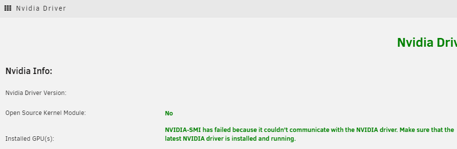

Plus the nvidia driver page  it shows this:
Yet I have the latest driver installed.

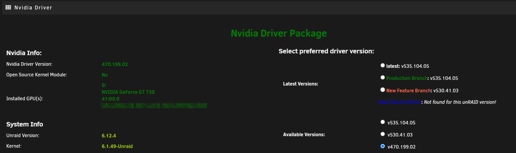

yes uefi mode, and i did get it to work, I had the most current firmware installed for nvidia, but that kept giving me issues, so I seen that ver 470.199.02 was listed and thought to give that a try. I installed that and the GT 730 booted into GUI mode without issue. Took me forever to figure out the issue but its resolved now.
A GT730 is only compatible with the legacy v470.xx drivers but besides that, did you solve your boot issue?
