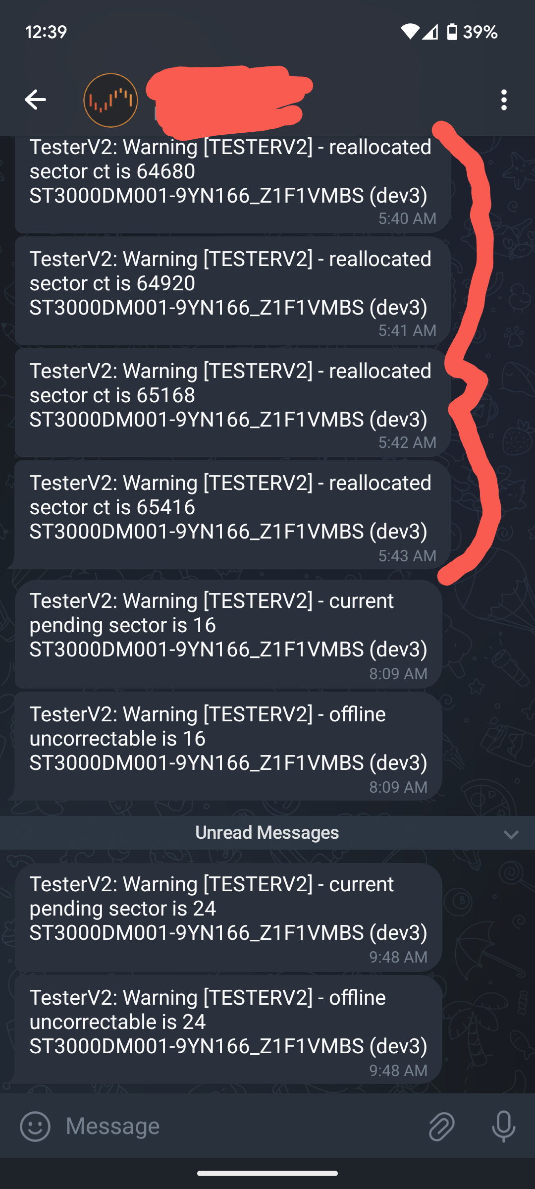

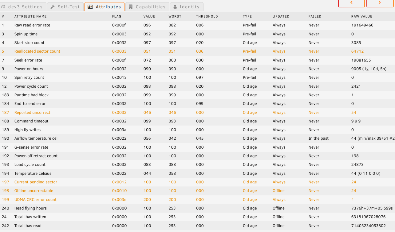

Reallocated sector count of 64,712 โ€‹ ๐Ÿ˜‚ โ€‹
I'm assuming a reallocated sector count of 64,712 is hilariously bad!
is this the worst??:
ย
I'm new to Unraid and this is a test rig at the mo, with no data on there to lose. Have been watching the awesome @SpaceInvaderOneย on YT (Total Legend) and playing with the preclear plugin.
I had to mute the Telegram bot i set up as it spent the last day and a half relentlessly spamming me with notifications. The other drives i pre-cleared were done just fine but this one, the preclear log suggests it gave up at quarter past one this morning:
ย

Sep 06 01:15:42 preclear_disk_Z1F1VMBS_20858: S.M.A.R.T.: Error:
Sep 06 01:15:42 preclear_disk_Z1F1VMBS_20858: S.M.A.R.T.: ATTRIBUTE              	INITIAL	NOW  	STATUS
Sep 06 01:15:42 preclear_disk_Z1F1VMBS_20858: S.M.A.R.T.: Reallocated_Sector_Ct  	0      	15624	Up 15624
Sep 06 01:15:42 preclear_disk_Z1F1VMBS_20858: S.M.A.R.T.: Power_On_Hours         	8965   	8994 	Up 29
Sep 06 01:15:42 preclear_disk_Z1F1VMBS_20858: S.M.A.R.T.: Runtime_Bad_Block      	1      	1    	-
Sep 06 01:15:42 preclear_disk_Z1F1VMBS_20858: S.M.A.R.T.: End-to-End_Error       	0      	0    	-
Sep 06 01:15:42 preclear_disk_Z1F1VMBS_20858: S.M.A.R.T.: Reported_Uncorrect     	30     	54   	Up 24
Sep 06 01:15:42 preclear_disk_Z1F1VMBS_20858: S.M.A.R.T.: Airflow_Temperature_Cel	40     	48   	Up 8    	->Failed in Past<-

at this point the reallocated sector count was 15,624, but my Telegram notifications show the process was still going after half past five this morning, and show the count continued way past 15,624 to the 64k range, where it is now.
ย
ย
Am just wondering how dreadful the state of the drive is, and why the preclear log suggests the process ended before it actually did. any comments or observations from the community would be welcome.ย ๐Ÿ˜ƒ
ย
Am just wondering how dreadful the state of the drive is...
Well, it looks like you already know the answer - it's an actively deteriorating drive that should be replaced ASAP.
