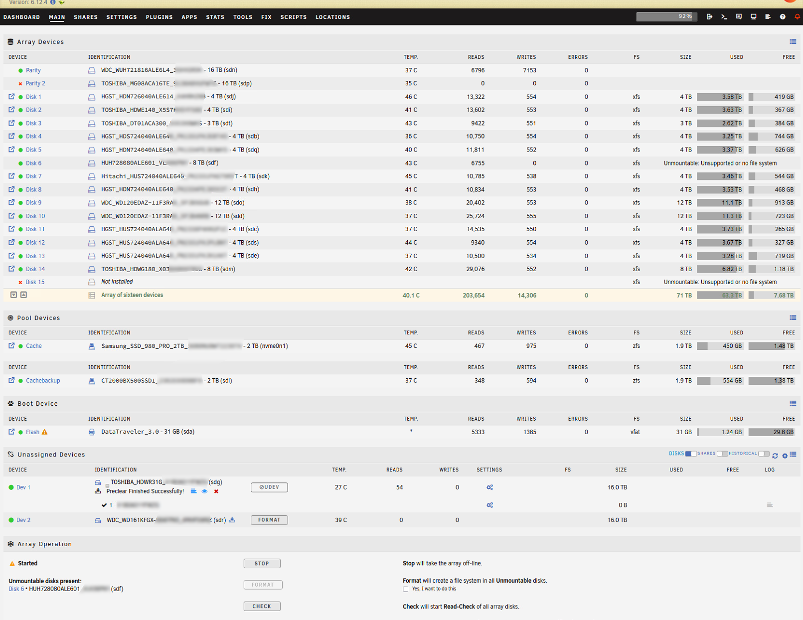

I am currently running xfs_repair on both the new array drives (6 and 15). Its been running for a couple hours and this is what I see
Phase 1 - find and verify superblock...
bad primary superblock - bad CRC in superblock !!!
attempting to find secondary superblock...
 Those dots ...... at the end, scroll horizontally for a long time. The read count on the drives keep going going up, so I will leave it for a while.
These two were the drives that unRAID rebuilt with one disabled parity drive. It ran it too fast (like in 6 hours) and I don't think it did a proper job. I still have one of the Parity drives showing as disabled.
I will wait for something to happen to the currently running repairs, reboot and run a new diagnostic.
Make sure you are running it without -n, but if it doesn't find a backup superblock after 30 minutes or so max, it likely won't find one.

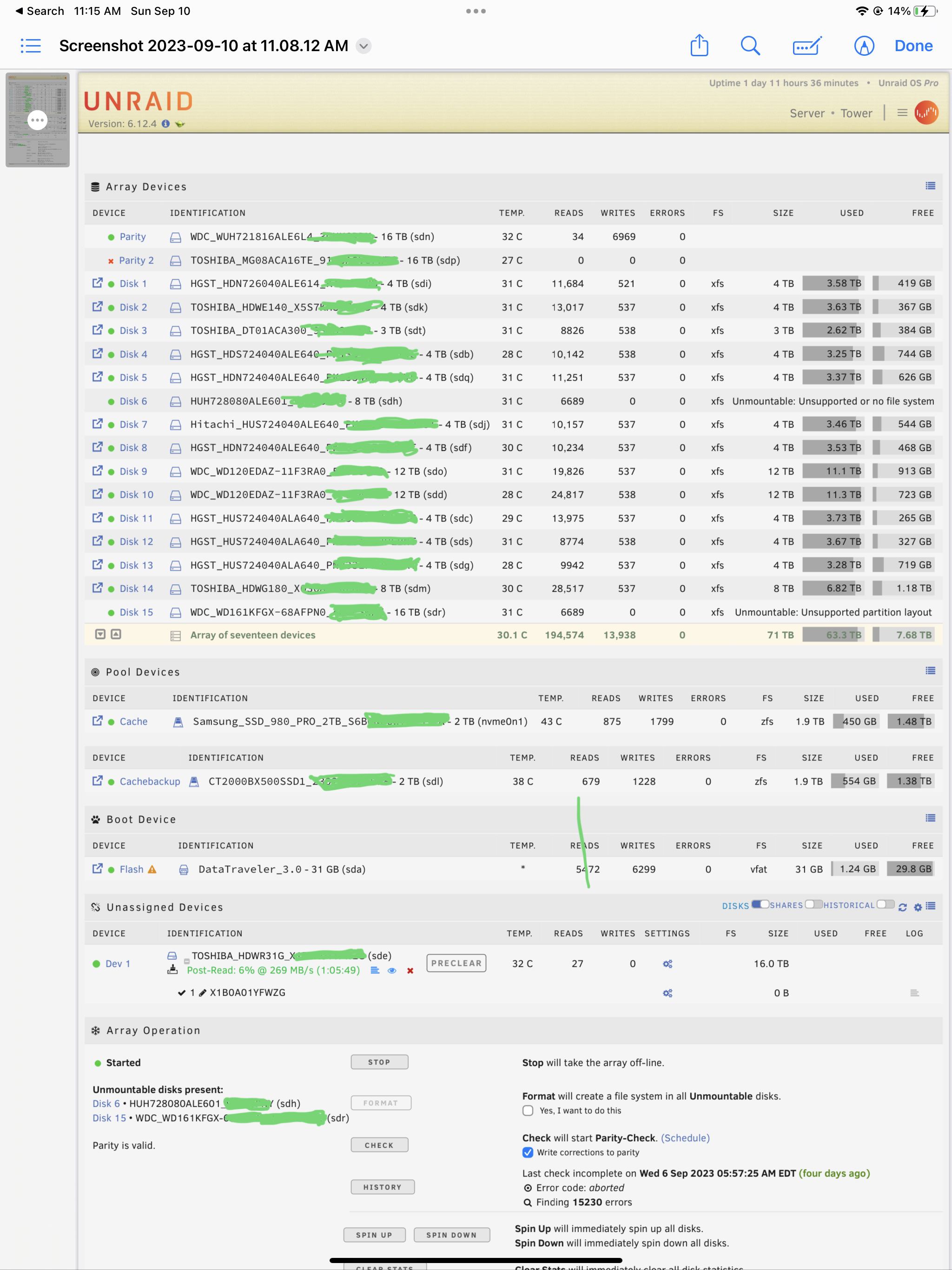

Started the array, and drives show un-mountable.

I ran the xfs_repair… it went through a lot of errors. When it finished, I started array, and there was only a “lost and found folder”. In it, there are many numbered folders. Some were empty, and some had files in it. Since it’s media, I can decipher what they are. I am not sure how complete it is.
i still have it showing as “no device” since we unassigned it. Should I assign the drive again and have it rebuild? Feeling some hope.
thank you.
