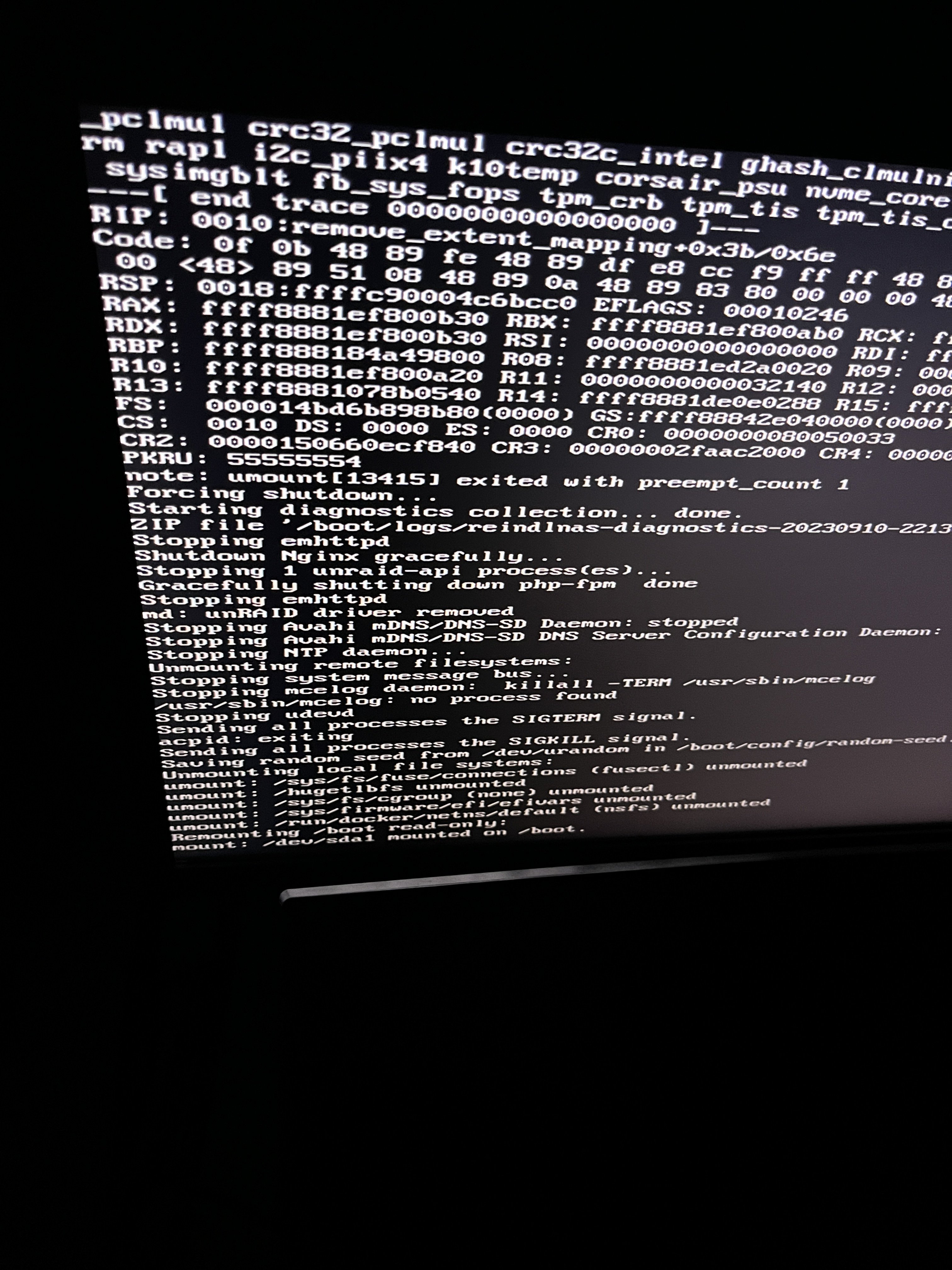

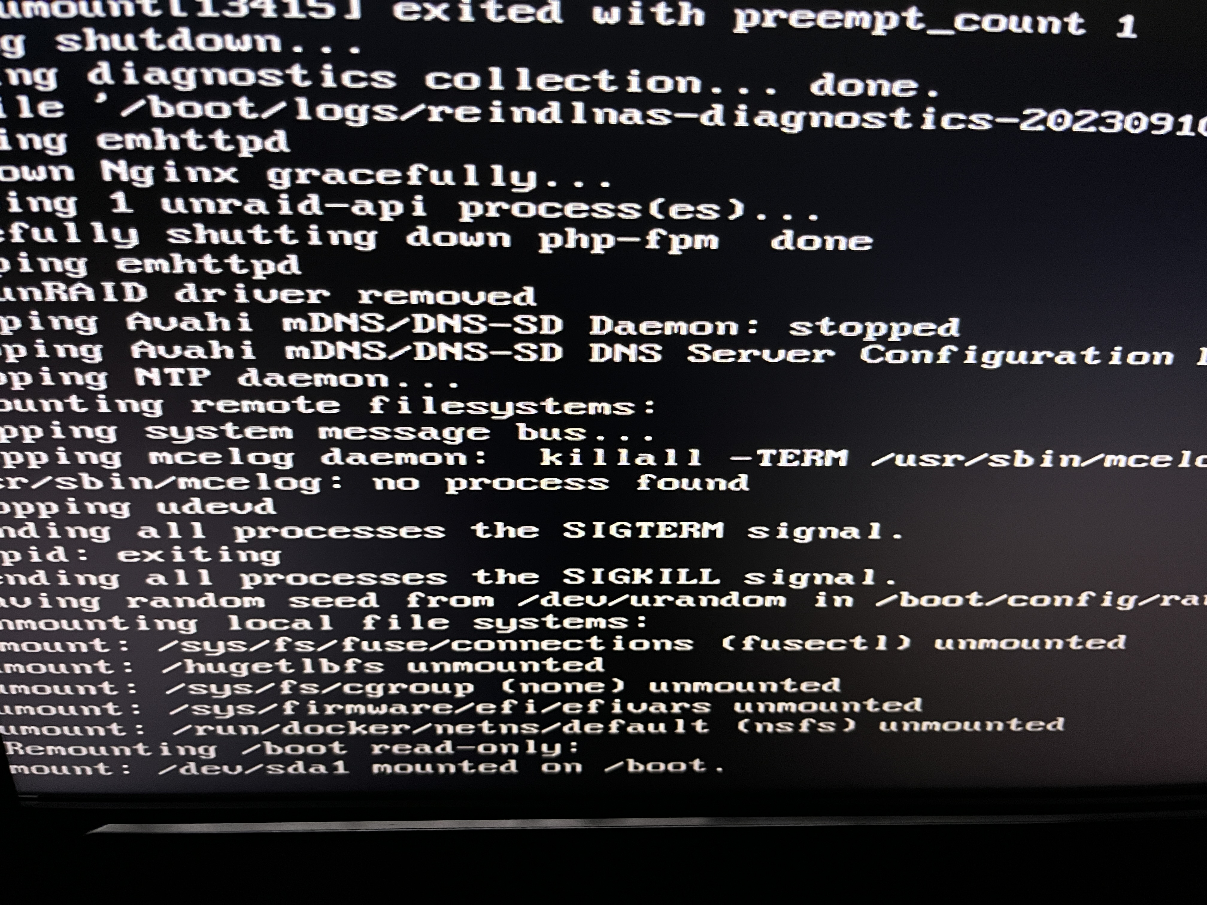

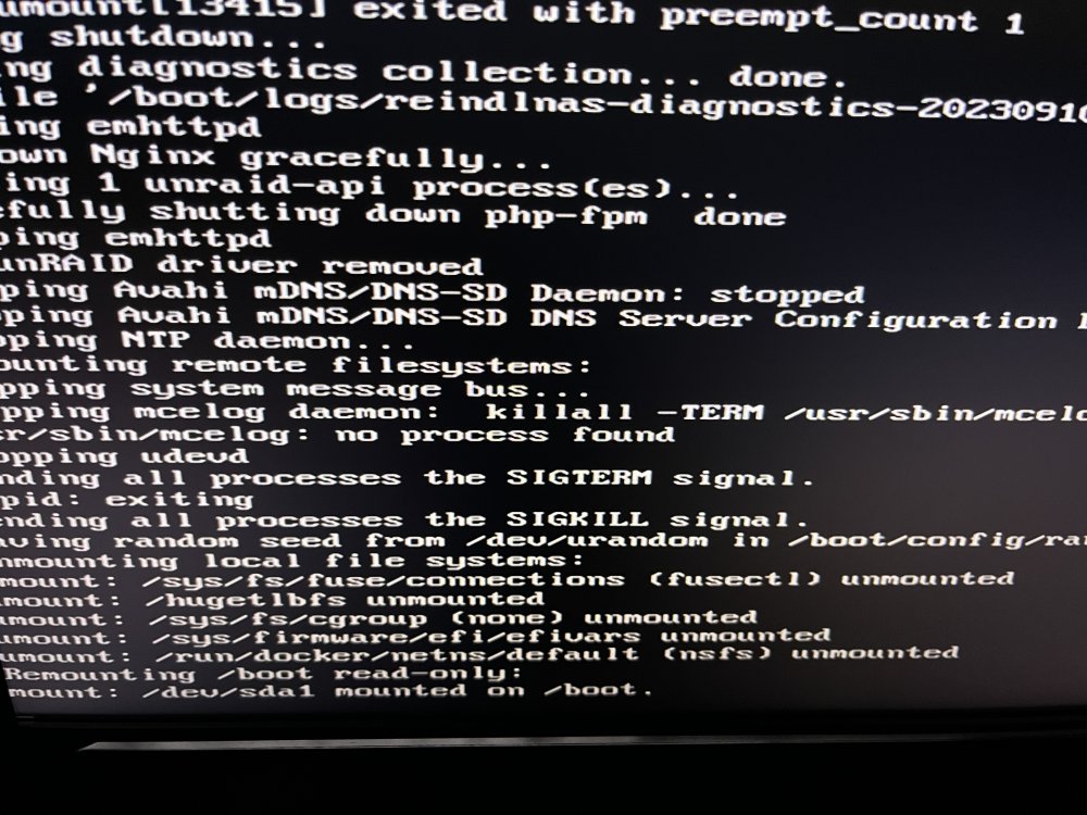

September 11, 20233 yr Author Well it happened again, tried to turn my server off and it got stuck. This time I had a monitor connected!
September 11, 20233 yr Community Expert The diags were saved to the flash drive logs folder, please post those.
September 11, 20233 yr Community Expert Cache filesystem crashed during unmounting, suggest backing up and re-formatting cache.
