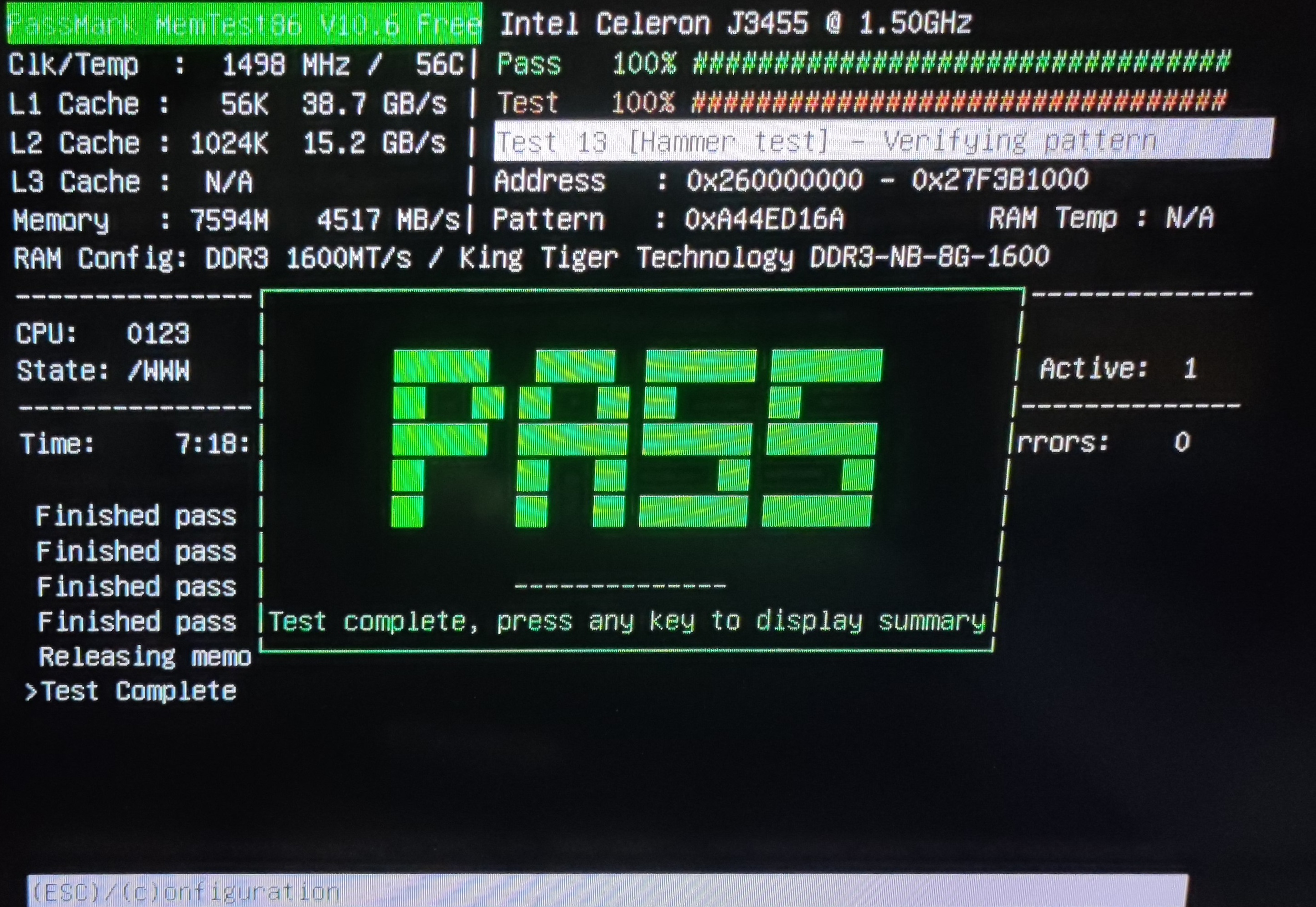

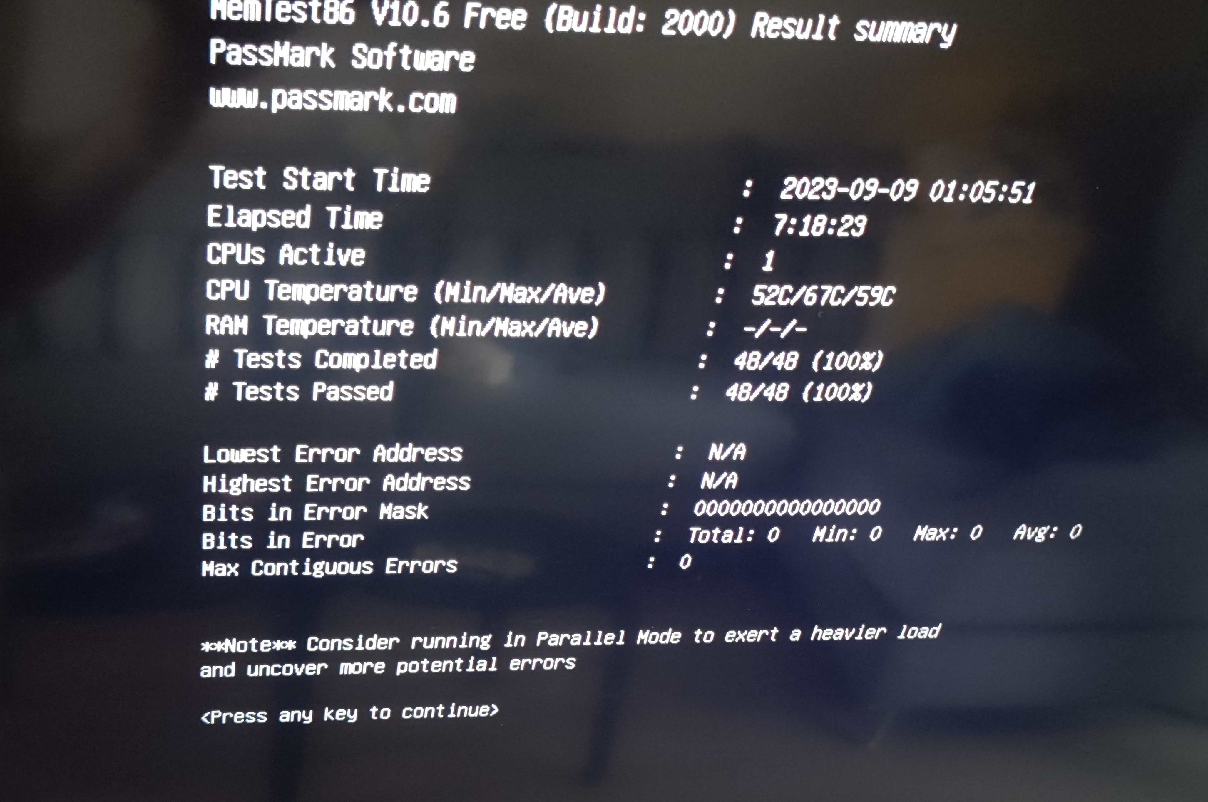

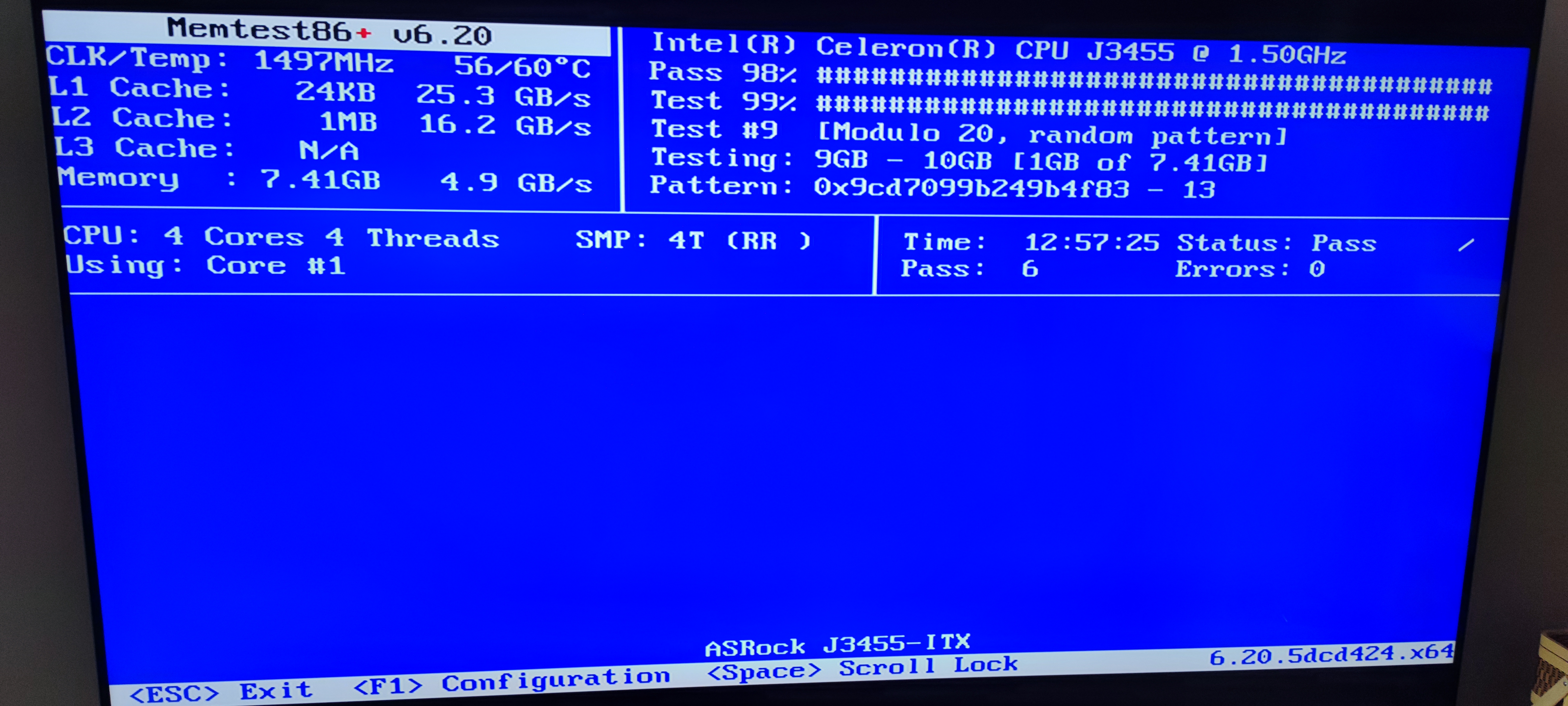

I try to memtest,but not fund any error.IMG_20230909_165035.thumb.jpg.c3e256e2d58d2bec8663fc8869a74b36.jpgIMG_20230909_090317.thumb.jpg.334ee7e3f0245d5ba508045de09a83fb.jpgIMG_20230909_164921.thumb.jpg.c0ddfd476f09d8d0fe1cd922fd6089f8.jpg

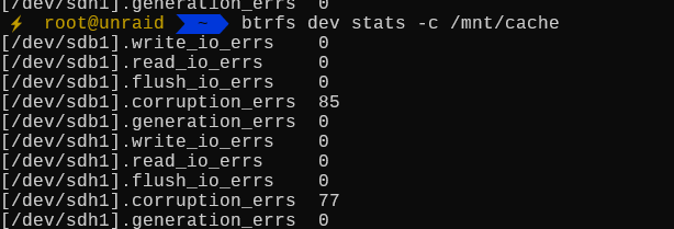

i clean all error,but now i found more errors,i don't know how to fix this。
Most likely explanation would still be bad RAM, or a board/CPU/controller problem, see if you can use a different RAM stick, also run a correcting scrub on the pool.
