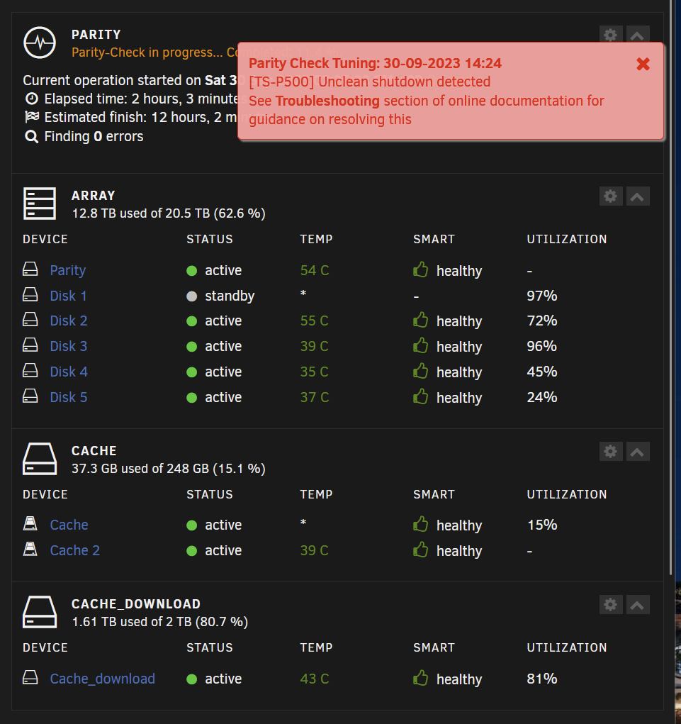

I also getting this Unclean Shutdown detected from time to time.
I've just update a docker and some plugin.
I did a reboot and after the server rebooted i got a message Unclean shutdown detected and my parity check start.
I would like to know whats the issue as well and what should i do to resolve this.

12 minutes ago, JorgeB said:
This is related to the parity check plugin, make sure it's updated to latest, if it doesn't help use the existing plugin support thread:
https://forums.unraid.net/topic/78394-plugin-parity-check-tuning/
The Plugin is up to date.
Should i uninstall the parity check plugin?
No.  The plugin will never cause an unclean shutdown to happen but it simply tries to make it obvious when it happens.
The message is correct if a parity check started.   Have you looked at the section of the documentation that the notification suggests you look at.

16 minutes ago, feins said:
Where is the Troubleshooting online doc?
The online documentation is accessible via the Manual link at the bottom of the Unraid GUI.  In addition every forum page has a DOCS link at the top and a Documentation link at the bottom.  The You want to go to Unraid OS ->Manual->Troubleshooting section for guidance on Unclean shutdowns.
