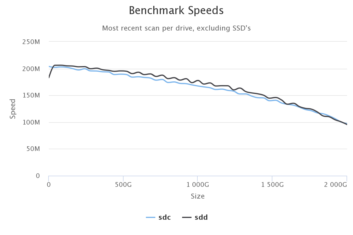

Nothing obvious, run the docker diskspeed test to confirm the disks is performing normally.
Not much to report from diskspeed, thanks for the suggestion though. Ran it multiple times with different percentages and saw similar performance.
The array speed is fine once it's mounted, but it's just that initial 12min freeze that's very odd. Stopping the array responds quickly, within 10 seconds.
