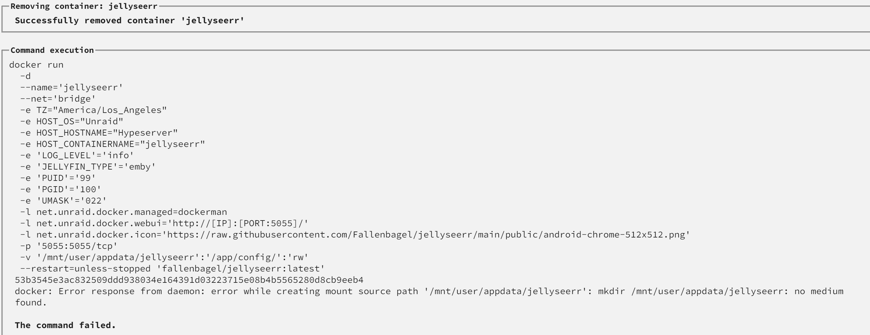

I've had pretty good success with the docker interface until today.  WhenI try to create a new container I get the error in quotes below. I've got other container running and there is other data in the appdata share.  I've got ~5tb available on the relevant array/drives. Any suggestions would be much appreciated.
I've tried to add a folder to appdata via: Krusader, CLI, and in windows with SMB.
"docker: Error response from daemon: error while creating mount source path '/mnt/user/appdata/jellyseerr': mkdir /mnt/user/appdata/jellyseerr: no medium found."
