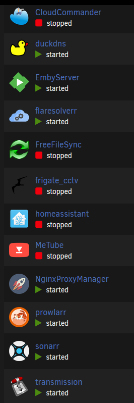

How many dockers do you have?
12.....
Edit each to see what host paths you have. Be sure to check under "show more settings"
