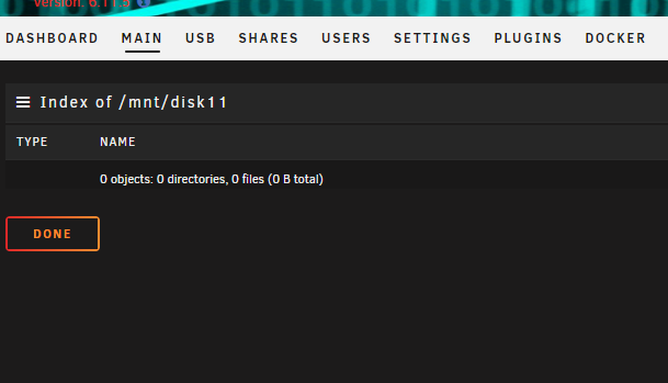

unselected disk, array online
No emulated data available.
fresh diags below.
again. i dont care about the missing data.
How do i get back to good state?
select disk and format?  then resync?

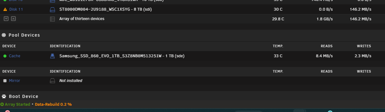

screw it. mounted, formatting...
says data-rebuild paused?? wtf?
hmm.... rebuilding something...
but there was nothing when unmounted, no emulated data.  still said unmountable...
hmm...
we'll see what gets written
so far....?
Disk was disabled so it needs to be rebuild, but since it was formatted it will be empty.
rebuilt after formatting disk....
