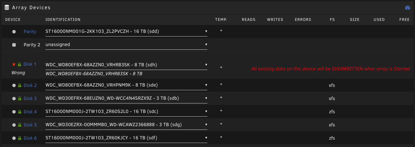

September 12, 20233 yr Hi, I stopped my array this morning and I'm now getting this error message: All existing data on this device will be OVERWRITTEN when array is Started Disk 1 is seen as a replacement disk by unraid, which is not correct. No disk was changed. Additionally this disk shows a high number of UDMA CRC errors. I'm not sure if these errors were already there yesterday, but Unraid did send a notification about these, after shutting down the array. While UDMA CRC error count often means that the SATA cable is defect this won't help me with the error message that the data will be overwritten, right? Edit: I just checked, and the UDMA CRC error count was the same in January, therefore I don't think that this is an issue. What should be my course of action? If the drive is really defect, I don't want to replace it, because I've got enough space left on the other drives, should I proceed like that? 1. Unassign Disk 1 2. Copy the emulated data from Disk 1 to somewhere else 3. Create a new config without Disk 1, and rebuild Parity. If the drive is not defect (which is what I currently assume), I should be able to just start the array and the same data would be rebuild on Disk 1, without any data loss, right? gandalf-diagnostics-20230912-0947.zip Edited September 12, 20233 yr by MarcelCliff
September 12, 20233 yr Community Expert Disk1 is being detected with a slightly larger capacity, did you change controllers?
September 12, 20233 yr Author 47 minutes ago, JorgeB said: Disk1 is being detected with a slightly larger capacity, did you change controllers? No, I did not touch the hardware. The last thing I did before stopping the array was moving ~7TB to Disk 1 which was newly formatted as zfs.
September 12, 20233 yr Community Expert Solution That's strange, disks don't usually change capacity on their own, but since it did you'll need to rebuild, check that the emulated disk is mounting first.
