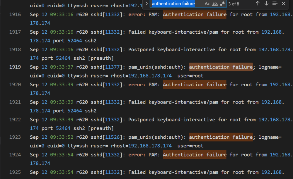

I get an ERROR 500 after updating to the newest Unraid Release
Try booting in safe mode in case it's a plugin.
tried that. not working, also tried rebuilding the flash drive.. nothing
 Maybe try to disable SSL authentication? I see the authentication failure error in your syslog.
Edited by JackieWu
no that was the login from ssh
Edited by aLinuxFreak
