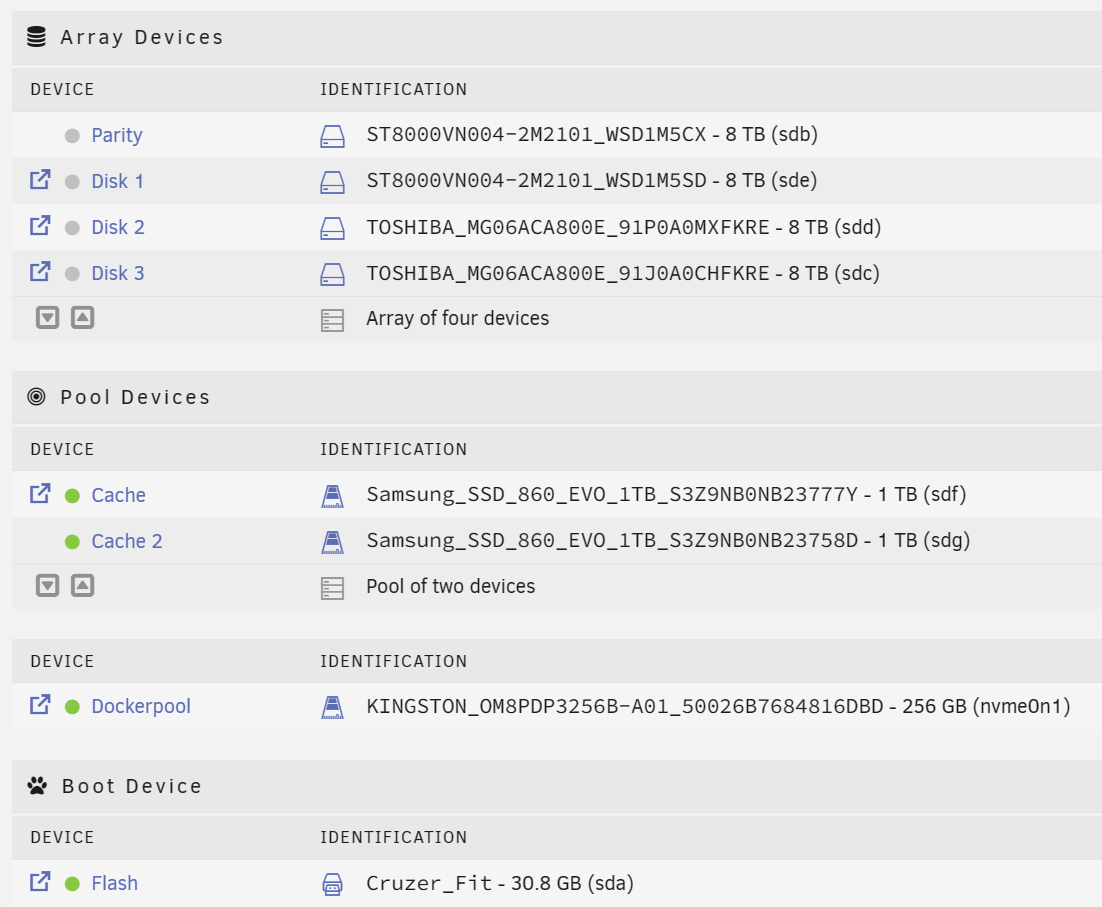

Below is my current disk setup.

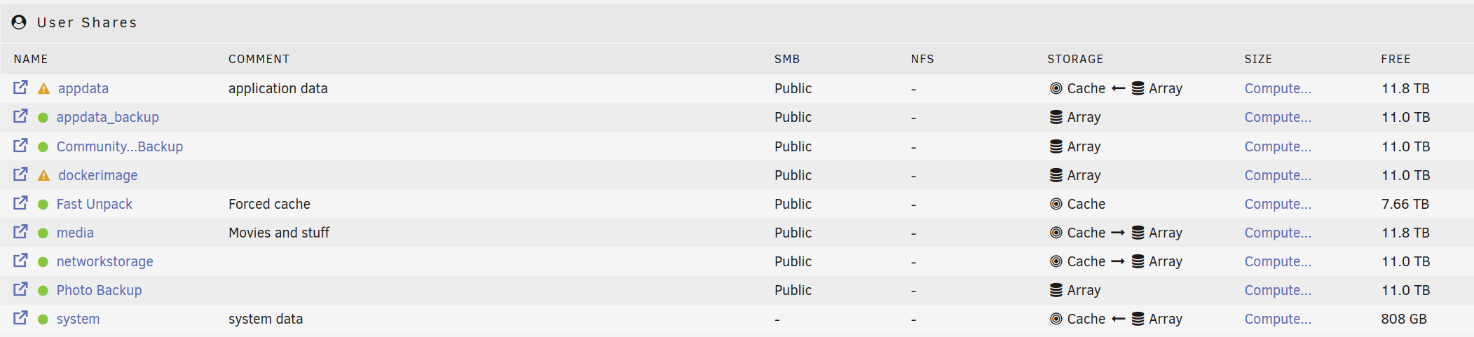

The current shares

  1. In my new rig, I will have an additional 2 x 2TB nvme drives that I plan to use as the new cache drives, replacing the above two Samsung SSDs.
  2. I plan to re-use those freed up 2 x 1TB SSDs to hold the data of what is currently "Dockerpool" above, to save the docker image and in the future possibly some VMs etc.
  3. So in the above, the Kingston nvme0n1 drive will effectively NOT be moved out of the old Unraid rig.

  1. To recreate the array without issues, I just have to make sure to re-assign the array disks by their ID to the correct slots once the disks have moved over to the new machine, right?
  2. To replace the cache drives, I will first have to change the cache preferences for all shares so that everything gets moved to the array disks with Mover, and once the disks are moved and the new 2 x 2TB nvme cache pool is ready in the new rig, change the cache preference settings again to what they were and run mover again in the new rig, correct?
Unraid recognises disks by their serial numbers - not by where they are connected so physical connection order does not matter.
If you have any hardware passed through to VMs then it is highly likely that the hardware IDs will be different on the new system so you should make sure no VMs are set to autostart, and remove any passed through hardware settings.    You can reset these as required once the system is up and running on the ne hardware.
