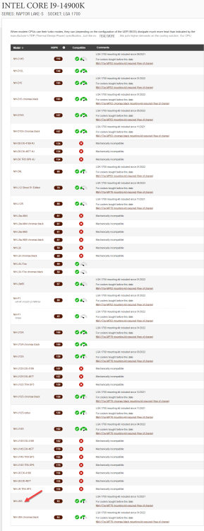

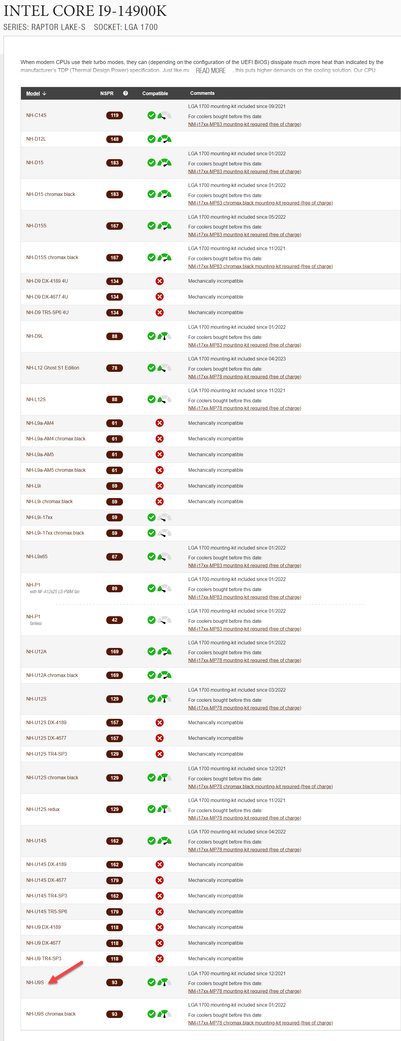

Correct its near the bottom of them all:
But its the only one that have a total height of only 125 mm (3U case)
