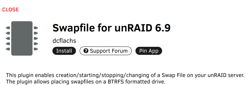

September 14, 20233 yr Author Thanks @JorgeB. I have 64GB RAM so I was sure that is enough. I will try with that swap file plugin but I see it's for BTRFS formatted drives. I have now every drive in xfs. Regards.
September 14, 20233 yr Community Expert 11 minutes ago, MarianKoniuszko said: I will try with that swap file plugin but I see it's for BTRFS formatted drives What makes you think that? It works fine with xfs formatted drives.
September 14, 20233 yr Author 2 hours ago, itimpi said: What makes you think that? It works fine with xfs formatted drives. Hi, I read that:
September 14, 20233 yr Community Expert At one point btrfs drives did not work correctly. If you look through the change history, then you will see that adding support for btrfs drives was one of the improvements and that is what that text refers to rather than meaning only btrfs drives.
