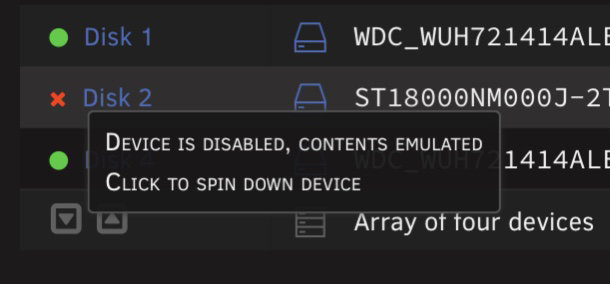

Device is disabled, contents emulated

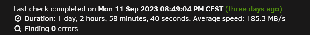

There's no rebuild in the diags posted, only a read check.
check I mean
Edited by JamesAdams
Yes, a check, not a rebuild.
To rebuild the contents of disk2 back onto the same drive you should be using the process documented here in the online documentation accessible via the ‘Manual’ link at the bottom of the GUI or the DOCS link at the top of each forum page.
if you are not sure what to do ask again here but with more detail on what you have tried so far.
Ok, thanks i go read that
It worked. Thank you.
