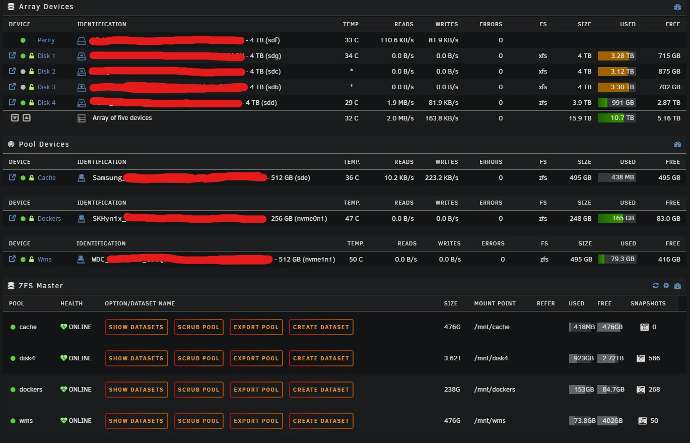

Array and pool setup.

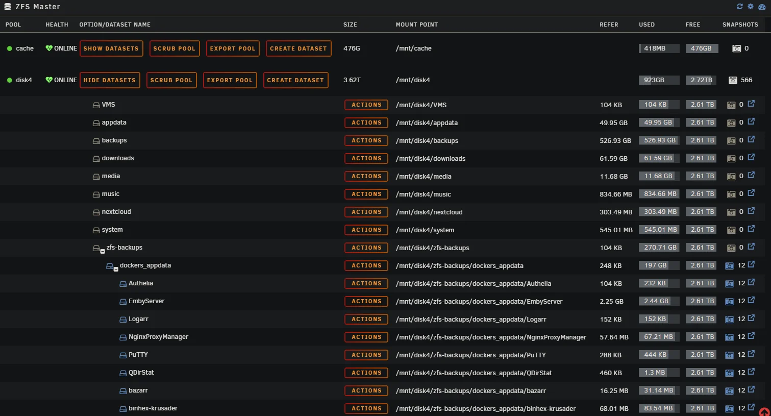

Example of the datasets on disk4

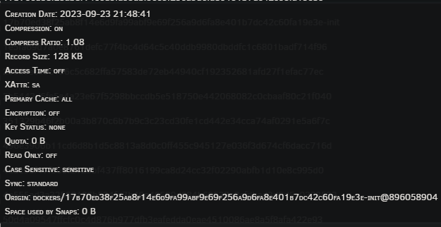

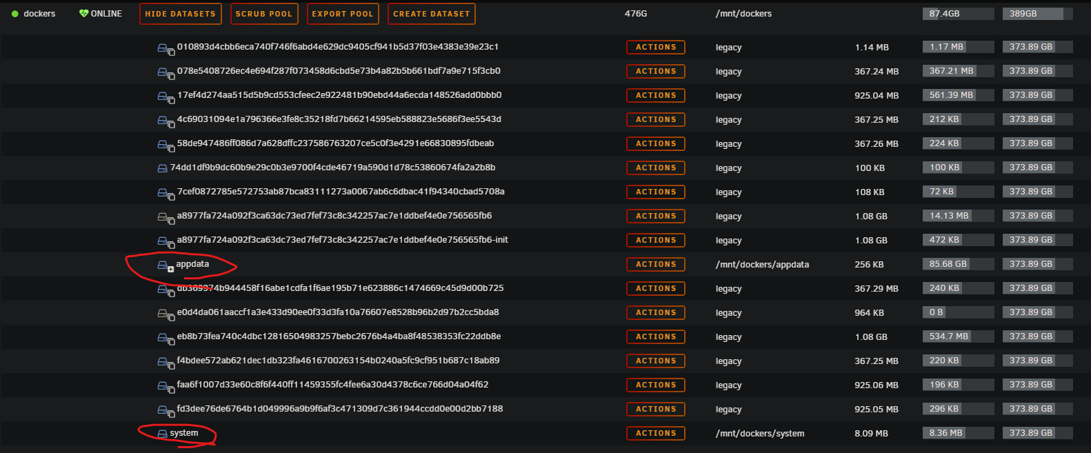

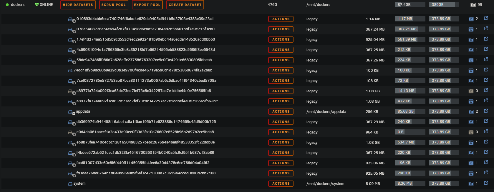

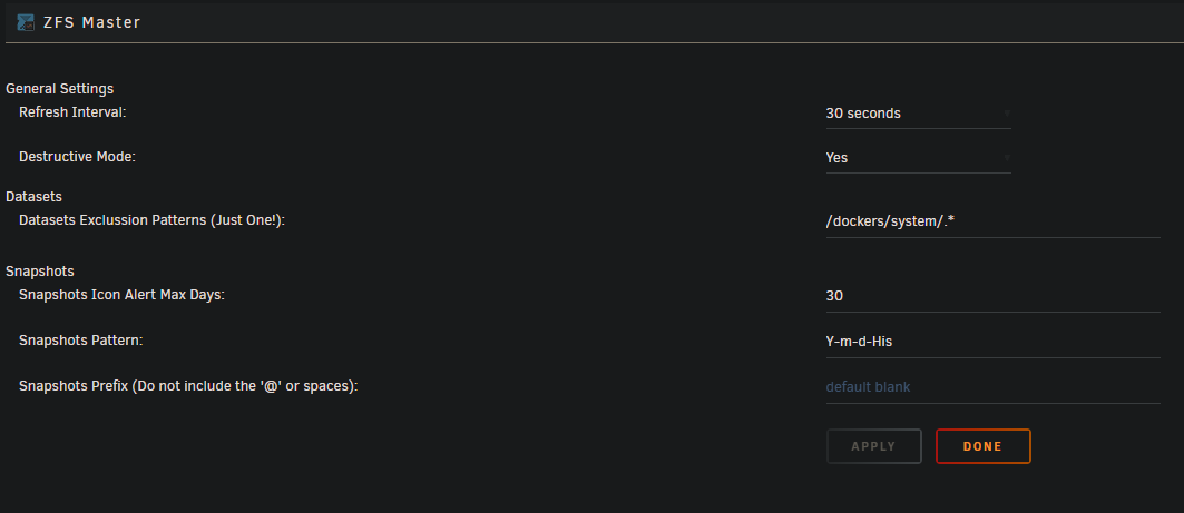

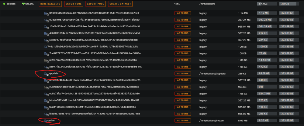

Is there anyway I can exclude these or change the default path ZFS uses for these newly created datasets?
When I hover over one of these docker created datasets (picture 04) it points to /dockers pool but mounting point is "legazy".
01 Legazy mounting point
02 ZFS master settings

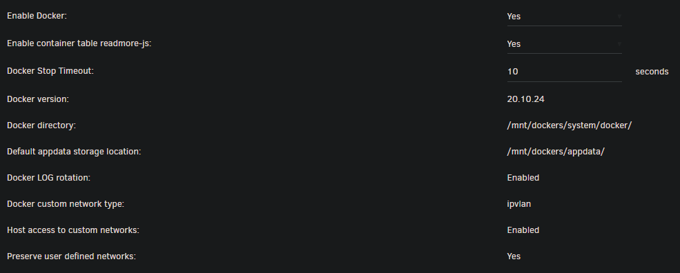

03 Docker settings
04 Hover over docker snapshot

Not sure I follow, legacy zfs datasets are a known issue if using a docker folder with zfs, no way for now around that AFAIK other than using an image instead, but the datasets should be created in the set docker directory
Edit:
Adding this in case someone stumbles on this topic later in the future. Read the bottom of the post after "edit" section.
Original post
Previously the docker snapshots where under dockers/system instead in root, if you can call it that. Not sure what the correct term is.

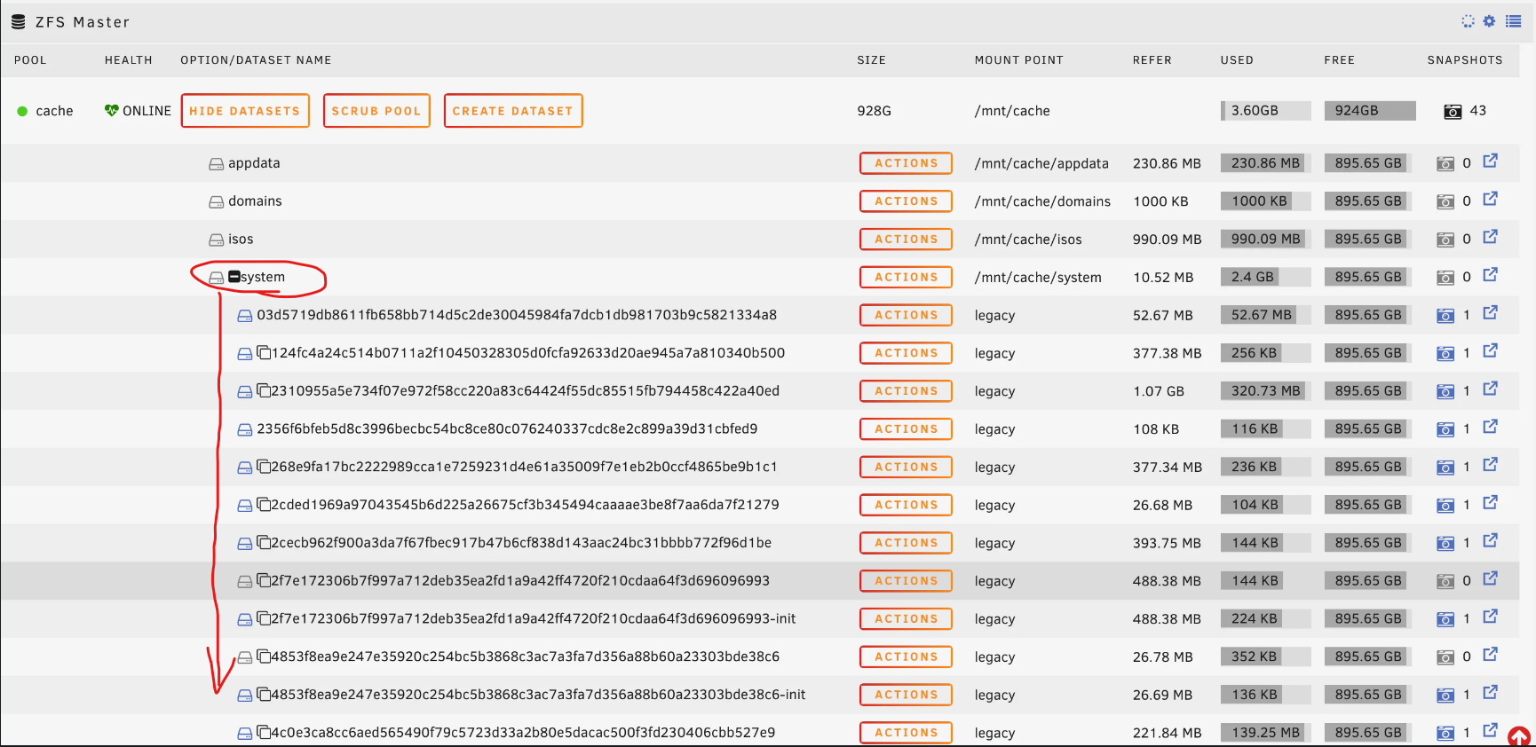

If I borrow an example screenshot from this reddit thread ZFS Snapshots creating themselves ???
01 Example how docker datasets used to look like.
If this was the case I could just exclude the path with ZFS master plugin. See picture 02 from previous post.
02 Docker snapshots appear in root instead under "system". Appdata appears correctly where all subdatasets are under "appdata".
This worked before when I first time converted folder to datasets using space invader one's video ZFS Essentials: Auto-Converting Folders to Datasets on Unraid
The script can be found from his github
I tried to use the script to somehow change the point where new datasets are created but couldn't get it to work. Probably because those are already datasets instead folders like when I previously used it.
I also tried to google ZFS commands to do this but I'm not exactly sure what I'm looking for.
