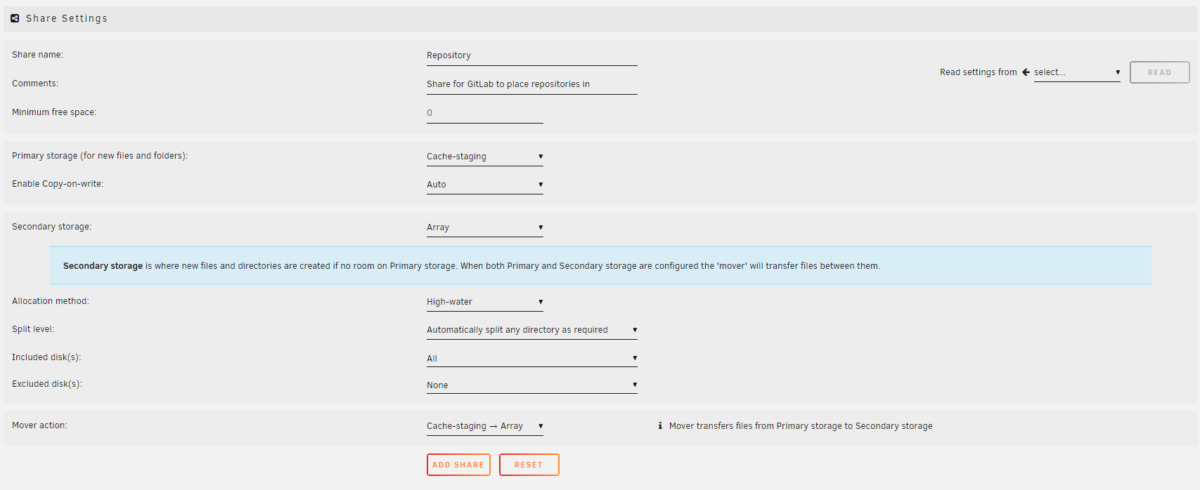

2. I can't figure out how to configure a user share to include a cache pool that moves it's contents to the array nightly. I watched some SpaceInvaderVideos for setting stuff like this up and it looks like unRAID 12+ changes the settings around a bit and they no long match the tutorials. This documentation goes in depth how to set it up for unRAID 11 or earlier: https://docs.unraid.net/unraid-os/manual/shares/user-shares/. It states "They achieve the same functionality as the settings available in 6.12 but are presented differently." but it does not present those differences. Hopefully I am just overlooking something, any updated documentation for this would be great.

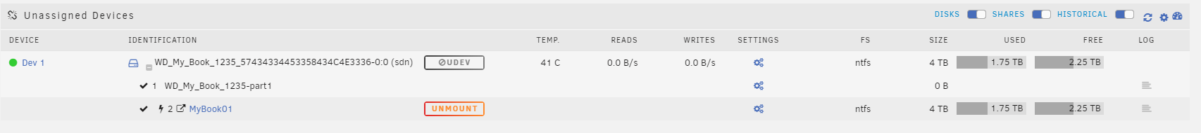

Quickly hit a third snag. Installed the Unassigned Devices plug in but I can't figure out how to get this external 4TB disk to mount:

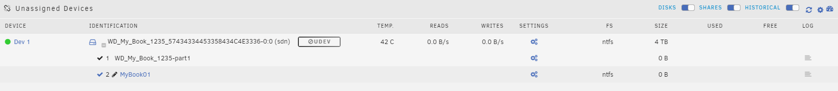

Found a workaround for not being able to access my external drive as an unassigned device. Was a long journey but I was able to setup a Windows 11 VM and pass the drive to it (which was a bit confusing as it was in some settings about boot drive priority).
I also moved that request for help over to the official thread for the plugin itself. I'd still like to be able to use UD for external drives as I have another and it's a lot larger.

The steps required for 2) are in the 6.12.0 release notes but can be summarised as
  • Go into the settings for the share in question.
  • Set the pool to be primary storage (i.e. place files are preferentially initially written)
  • Set the array to be secondary storage
  • Set move direction to be cache->array.
Turning on the Help built into the GUI gives information on the various settings.

Thanks for the tip! I think help comes on by default and is actually what caused my confusion. The little tip says that secondary storage is where things write to once primary storage is full but what I had read about was the ability to move things to the Array at 3:40 AM each night. Here is a picture of what I am talking about:

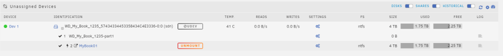

Update on the unassinged device. For some reason when I shut down the VM it mounted fine and I can now interact with it's filesystem without the need of a Windows 11 VM:
That statement is true as it refers to new files.   If primary storage is below the Minimum Free Space value then primary storage is bypassed and written directly to secondary storage.    For files on the cache pool then the mover setting is relevant.
Got it. So any cache pool with a secondary drive will move files in the direction that is configured via "Mover action" when the mover is ran. Normally this would be from cahce -> array at 3:40AM but I guess if you wanted to clear files off of the array you could switch the direction.

They changed the way these are configured between 6.11 and 6.12. Any Cache with an Array as secondary will respect the mover schedule and the direction of files being moved is specified in the share.
There is a bug in the UD plugin where you can't mount a drive that has a partition with no file system. This will be fixed soon but can be worked around by Detaching and Re-Attaching the Unassigned Device with Auto Mount enabled. On reattach it should auto mount. You can also access drives in this state inside of a Windows VM.
