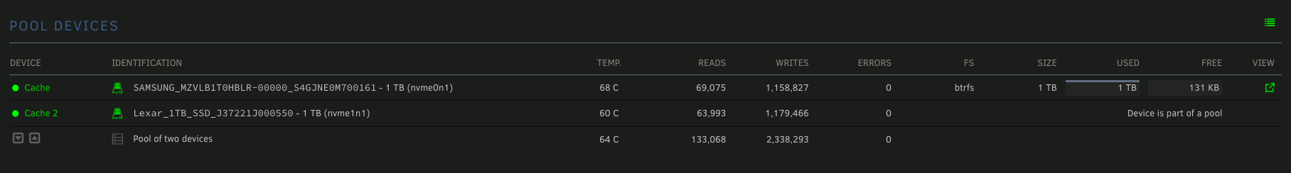

I have a cache pool but it is full, I would like to clear the cache but I have no idea how to do so.
I have tried:
- Click the "Move" button
- Reboot the server
- Disable VM & Docker, then click the "Move" button
- Change the cache setting of share (Prefer, Yes, No)
But none of the above works, the cache drive is still full.
Should I using rm all the files in /mnt/cache using terminal?
Would anyone can provide me a solution?
The diagnostics is still running, I will upload the file when it is ready.
Thanks a lot.

Thanks for the reply.
I am using 6.11.4 and have not installed the Mover Tuning plugin.
As the cache drive is full, the SMB file share, docker and VM are all affected.
So, if I want to clear the cache driver, I need to change the Cache setting to Yes from Prefer?
Thanks.
