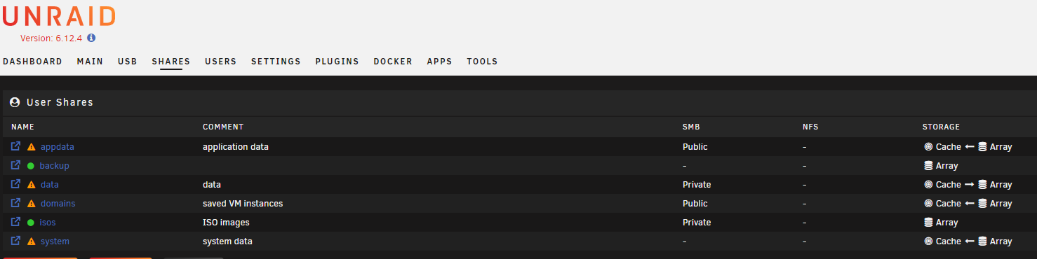

Hello all,
I have been trying to get my share configuration properly done but I keep on getting warnings that files are not protected.
I have been reading on best practices, very different opinions out there. :)
I mainly do media streaming and smart home processing, nothing major.
Can someone help me understand what I am doing wrong?
Thank you for your help :)

Solved by JorgeB
Since you have a single device pool, i.e., without redundancy, any share that has files on that pool will appear as unprotected, this is normal.
