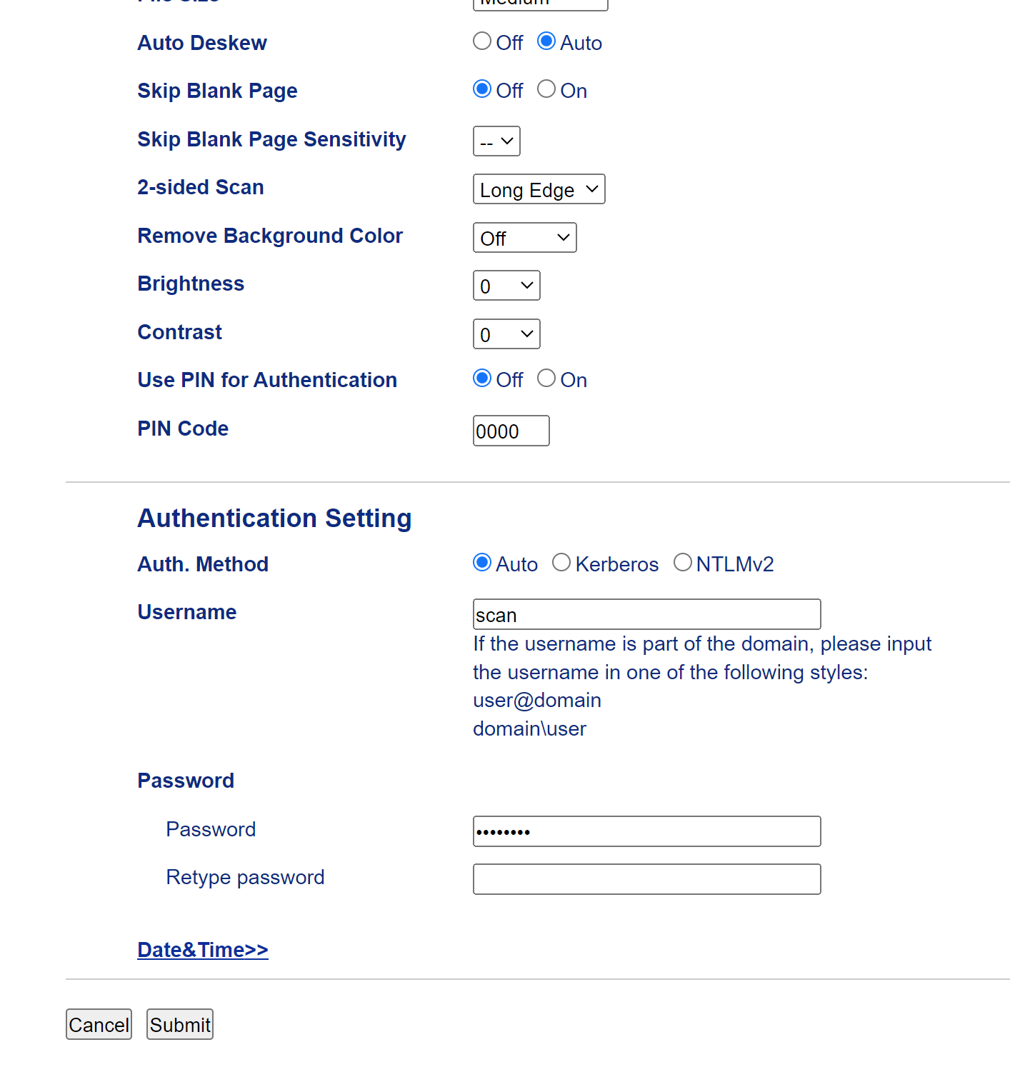

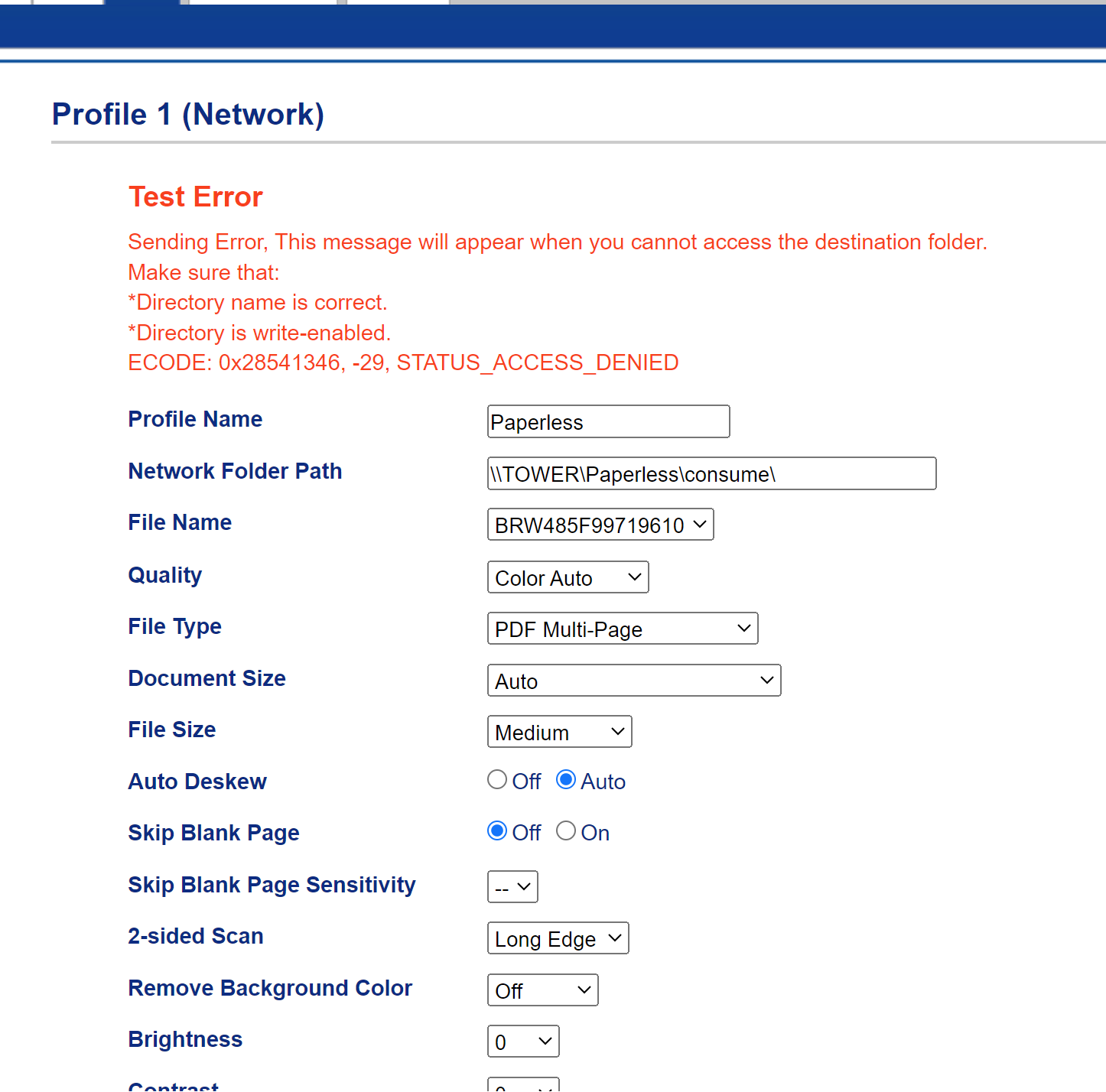

September 15, 20233 yr I'm trying to set up a Brother MFC-L3770cdw printer to scan files to an unraid share for Paperless-ngx. I keep getting an access denied error. I can connect to the share in windows using the user credentials I set, and the printer *can* connect to the share if I set the share to public (though it tries to ask for a username because one is not set in the printer's scan profile, which is not acceptable UX for my users), so the network folder path appears to be correct. It seems like something is causing Unraid to reject the credentials. I have tried what seems like every possible permutation for the user credential format and authentication, but I must be missing something. Any help would be appreciated.

September 16, 20233 yr I got it working using the ip, without domains. Might depends on how your server is setup. Buy I suppose if on the same domain, it's not required. Also remove the last \ in the path. ip\path

December 29, 20232 yr I had a similar issue with a Brother ADS-1700W, it turns out that the password box in the scanner's web UI has a character limit (33) and my unraid user's password was longer than that. I changed the password to length 30 and it works.
February 11, 20242 yr I just solved this today. It was a permissions issue with the share. I ran the Tool->New Permissions on my paperless-ngx share and it started working immediately.
