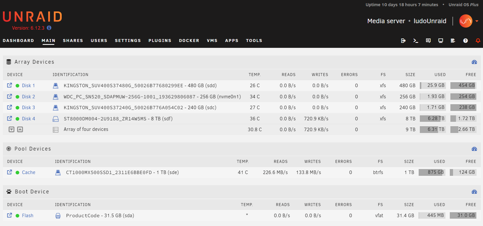

I'll upload what mine looks like, but like I said, it seems broken.

Writing to the cache is fine, I write at close to 2Gbps to the cache.
HOWEVER! The cache takes forever to move to the main array...
The cache is 1Tb and it takes ± 24h to move to the array ( 1-40Mbps).
The parity check on the array goes at ±160Mbps.

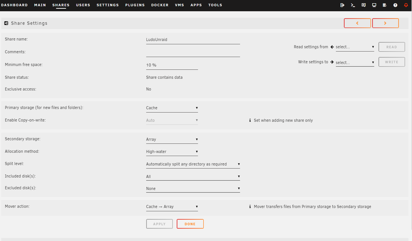

I've recently tried to add the mover plugin CA Mover Tuning and it only made things way worse
My main array is a bit unconventional, I took a few disks I had lying around, and I've just now disabled parity to see if it was the problem. ( it isn't )

You will not get anything like the raw disk speeds.
In normal mode then I would expect something like ~30MBs while with Turbo Write enabled more like 80MBs.   Those speeds would be impacted by anything else happening on the main array.  These write modes are described here in the online documentation.  There is also a non-trivial overhead associated with each file as mover carries out checks so with lots of small files then expect it to be even slower.

Ohh, so I guess 30 MBs is normal...
So I guess it's my use-case of moving 8-15Tb in one go that's kind of a worst case for Unraid  :/
