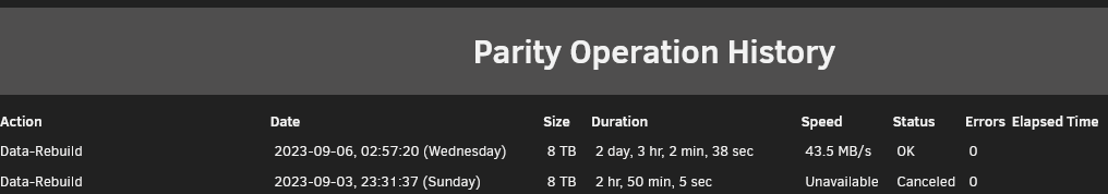

September 16, 20233 yr I had some troubles during the rebuild and had to restart the server, but the rebuild appeared to complete successfully: Any idea what could have caused this? This is the first time a disk died without warning and I've needed to use parity. I'm assuming the data from the failed drive's gone. Fortunately, I have most of it backed up. I am using syslog to save the logs, so should have logs of everything if they're of use.

September 18, 20233 yr Community Expert The disk was formatted zfs during the rebuild: Sep 1 21:11:53 Tower emhttpd: creating volume: disk3 (zfs) So any data there would be gone.
September 18, 20233 yr Author Thanks Jorge, I followed the official guide here: https://docs.unraid.net/unraid-os/manual/storage-management/#replacing-faileddisabled-disks I had missed the point in the notes there "The rebuild process can never be used to change the format of a disk - it can only rebuild to the existing format." I wasn't using the process to change the format, it was to replace a failed drive, so I skipped over this point. Then when it came to adding the new disk, I figured that as I was having to format the disk anyway, i might as well switch to ZFS so I can take advantage of some of its benefits over XFS like replication from cache etc. Now that I think about how parity works, I realise that there was no way it could have worked with a different format type. It was my mistake. This was the first time I rebuilt a disk from parity, so it was all new to me. Fortunately, none of the data on that disk was irreplaceable and I have a backup of most of it. I do think that there should be a bigger warning about this in the manual to make it clearer that a change of format will stop the rebuild from being able to work. Especially now that I'd imagine there are others like me who'd like to take advantage of ZFS since 6.12 and may be tempted to do what I did. Even better would be if there's a way for the system to check whether you're trying to rebuild onto a disk with a different format than the one being replaced when attempting to start a rebuild and give a nice clear data loss warning.

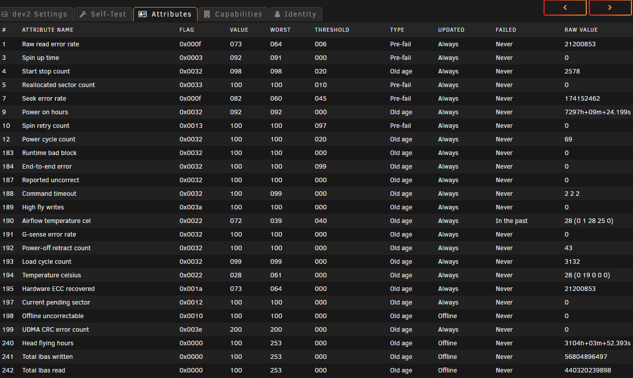

September 18, 20233 yr Author Having read about people having array drives come up as unavailable due to power issues, or other temporary issue, and turn out to be fine, I figured I'd stick the failed drive in a USB caddy, just to see if there were any signs of life. It's come up as fine, passed quick SMART test. So it may well have been a power glitch or something and a reboot would have fixed it. Not sure whether I should try to use this drive any more, in case there is something up with it. Here's its attributes: I can browse it and access files no problem. Is there any way to put this back into the array with its data intact, or am I better off copying the data onto the disk that's now in the array? So a few lessons learned here- triple read and have a good think about anything array related when there's any possibility of data being lost, and always try turning it off and on again! Edited September 18, 20233 yr by -C- missed some

September 19, 20233 yr Community Expert 9 hours ago, -C- said: Not sure whether I should try to use this drive any more, in case there is something up with it. I would suggest running an extended SMART test and only consider continuing to use the drive if that completes error free. If it is not unusual for the short test to work but the extended one to fail.
September 19, 20233 yr Community Expert 12 hours ago, -C- said: it doesn't mention anything about a different format breaking the rebuild process. Not specifically, but it does say format in NEVER part of a rebuild and doing it will result in that loss. 9 hours ago, -C- said: Not sure whether I should try to use this drive any more Disk looks fine, you can mount it with UD and copy the data to the new disk in the array.
