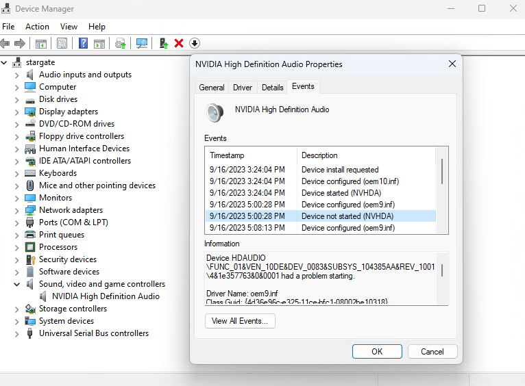

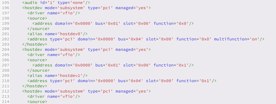

vm_xml.txtIm having an issue where I pass through a Nvidia 1080 ti to a windows 11 VM. I used the win11 template to create the VM. When i boot windows I can see the video card and sound card in device manager. The video card work with no issues. The sound card shows in device manager as working but when i check the events it says a device not started (NVHDA). When i look in the sound mixer it does not see the sound card.

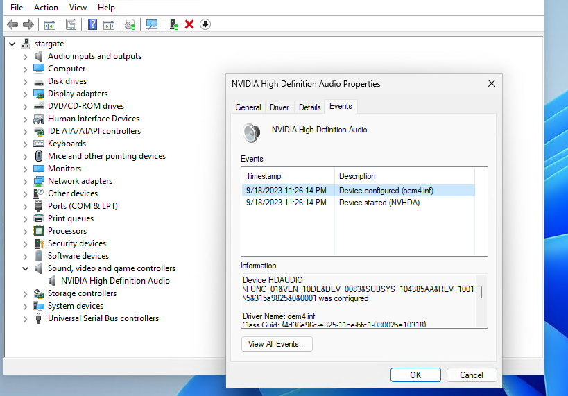

well i followed spaceinvaders tutorial and I dont seem to have the error any more but i have the same problem. looks good in device manager but windows sound mixer doesnt see the soundcard.

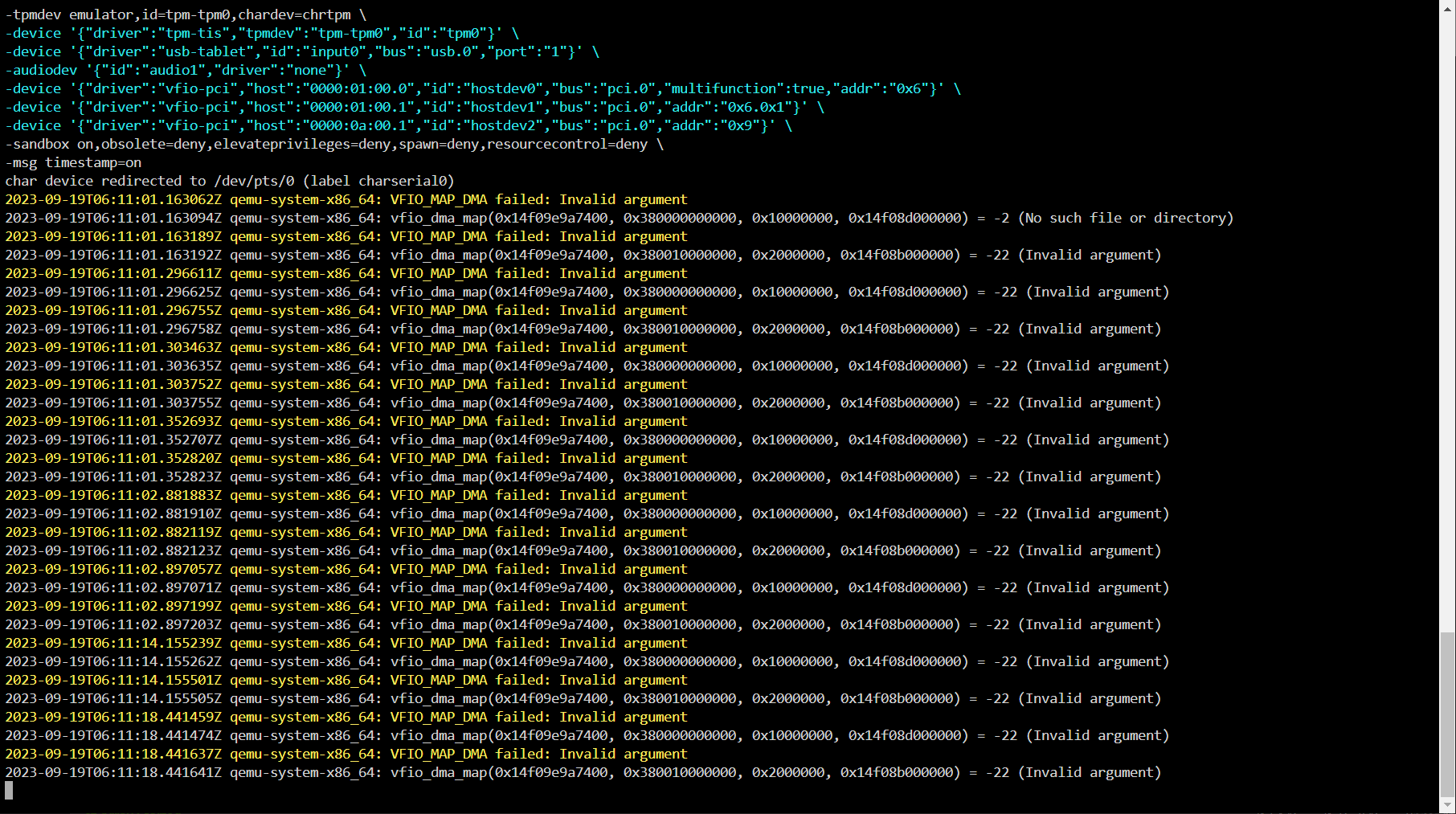

I have also noticed that i am getting this error in the log only after  I enable the video card pass through.
