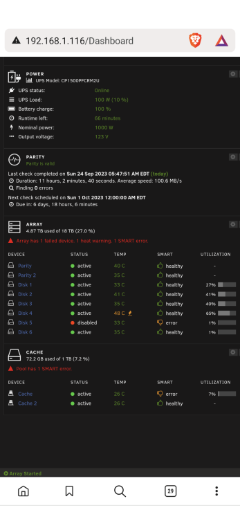

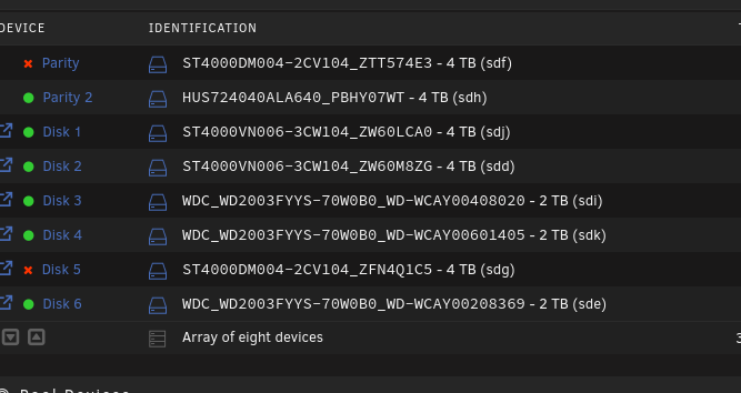

While trying to get GPU passthrough to work I was swapping the GPU and my sata expansion card pci slots and when I rebooted one of my parity and disks had a red x and says "device is disabled." I tried xfs_repair on the disk and it completed but nothing changed. None of my shares are showing up and I'm freaking out. Not sure where to go from here.  image.png.f5a2c69f530799dd2fadd28a1a0ffc63.png

ATA errors are gone, the disk controller is being passed through to the Windows 10 VM, remove these lines for the XML:

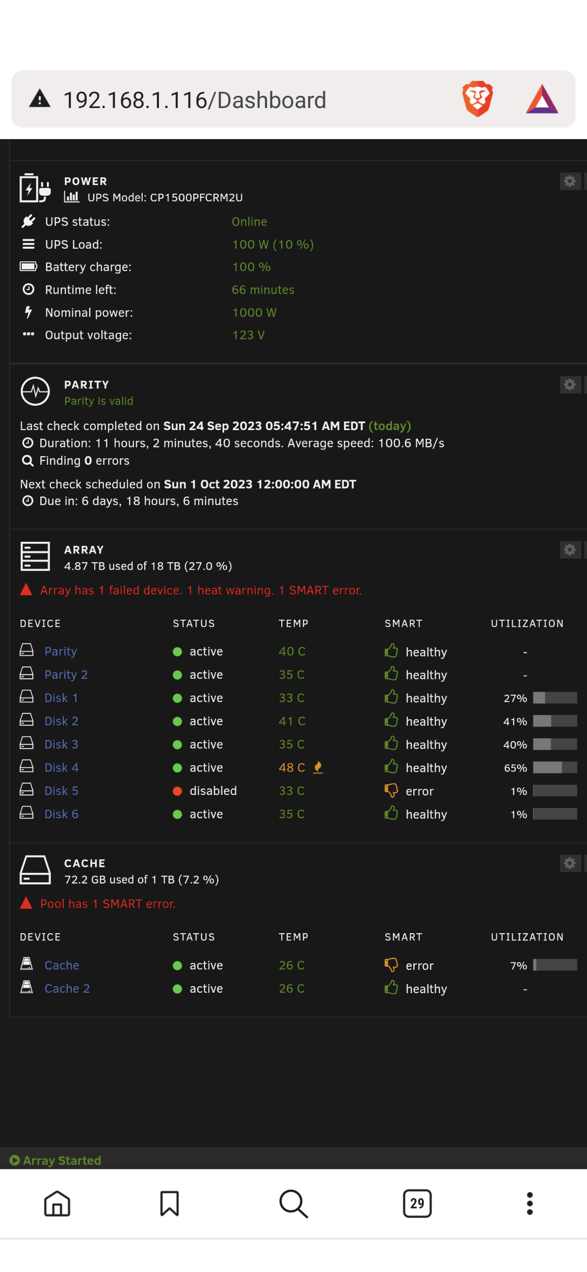

UPDATE: OK, I decided to disable VMs on this server and just use this one for a document/media server. I will build a second server for virtualization. I managed to do a parity rebuild on Parity 1 disk and it completed successfully. I am not so lucky on disk 5. It still says the disk is "disabled and the contents are emulated." I also have an error on one of the cache drives that I am not sure how to fix.
