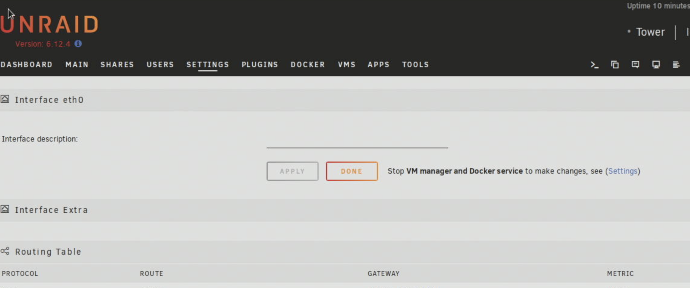

The most important is Tailscale since it breaks most of my automations: As per object i can't see anything under "Interface Extra" while i try to add the interface there. (screenshot attached)
Assuming you are using the plugin better to ask here:
No i wasn't using the plugin i was still using the docker container. I just installed the plugin and solved the problem.............. Sorry, didn't know there was a plugin at all.
