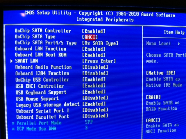

September 12, 201115 yr perhaps some drives are registering as IDE instead of SATA and AHCI. Check the BIOS on the board and if you see anything about IDE disable it.
September 12, 201115 yr Author perhaps some drives are registering as IDE instead of SATA and AHCI. Check the BIOS on the board and if you see anything about IDE disable it. I'm in AHCI mode in the BIOS. Is there anything I would need to do for my pci-e controller cards?
