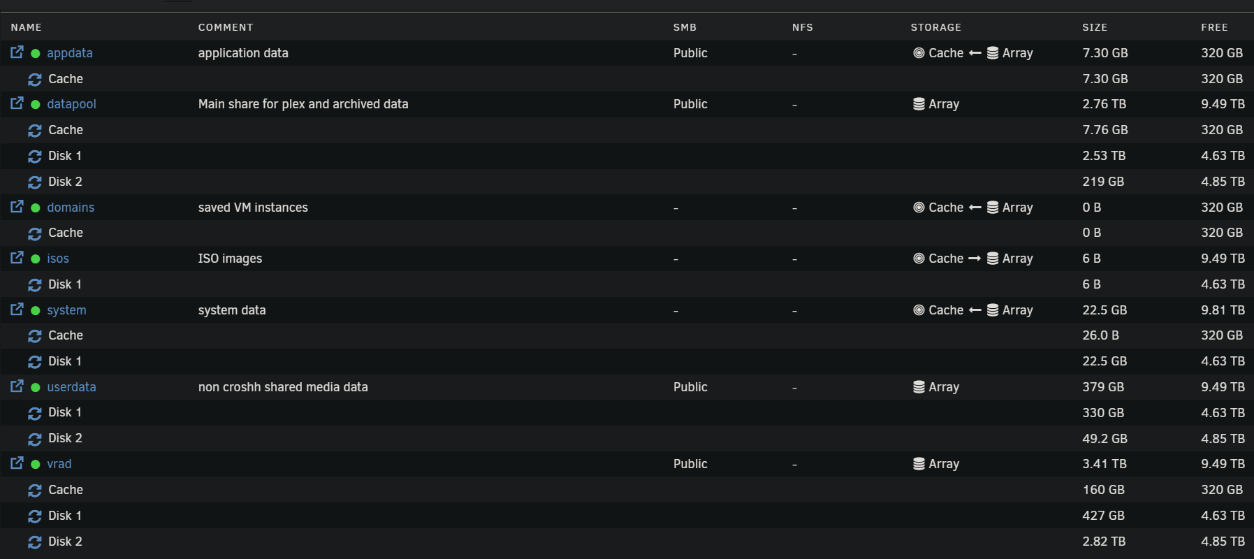

Also, your system share has files on the array.
16 hours ago, trurl said:
The usual cause of filling docker.img is an application writing to a path that isn't mapped.
Is files on the array bad? I'm not clear how that relates?
https://docs.unraid.net/unraid-os/manual/shares/user-shares/#default-shares
Ideally, appdata, domains, and system shares should have all files on fast pool with nothing on the array. If these are on the array, docker/VM performance will be impacted by slower array with its parity updates, and array disks can't spin down since these files are always open.
okay, well that was defaults. I didn't change anything there.
