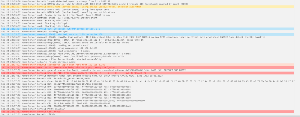

My System randomly crashes with what looks like seg faults. I can not figure out why.

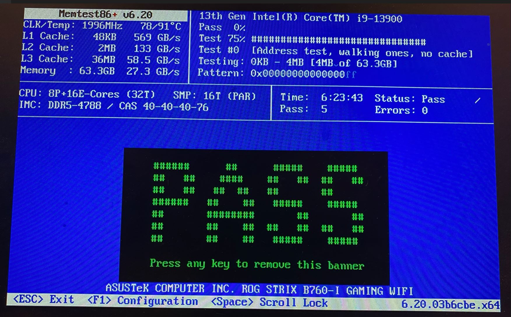

I have tested the RAM every way possible and it passes.fail.thumb.jpg.e1162dbcd677bb8c997b585eecccb408.jpg
I can not figure out where the fault is. It doesnt appear to be hardware. Issue never happens when the CPU is doing something always happens when things go idle.
home-server-diagnostics-20230919-1456.zip syslog

Crashes look hardware related to me, try with just on RAM stick, if the same try the other one, that would basically rule out a RAM issue, memtest doesn't always find every issue.

Both RAM sticks were run individually and it still crashed can't be the memory. Is there any additional debug switches that can be turned on that could give us some clue what is causing the constant crash?

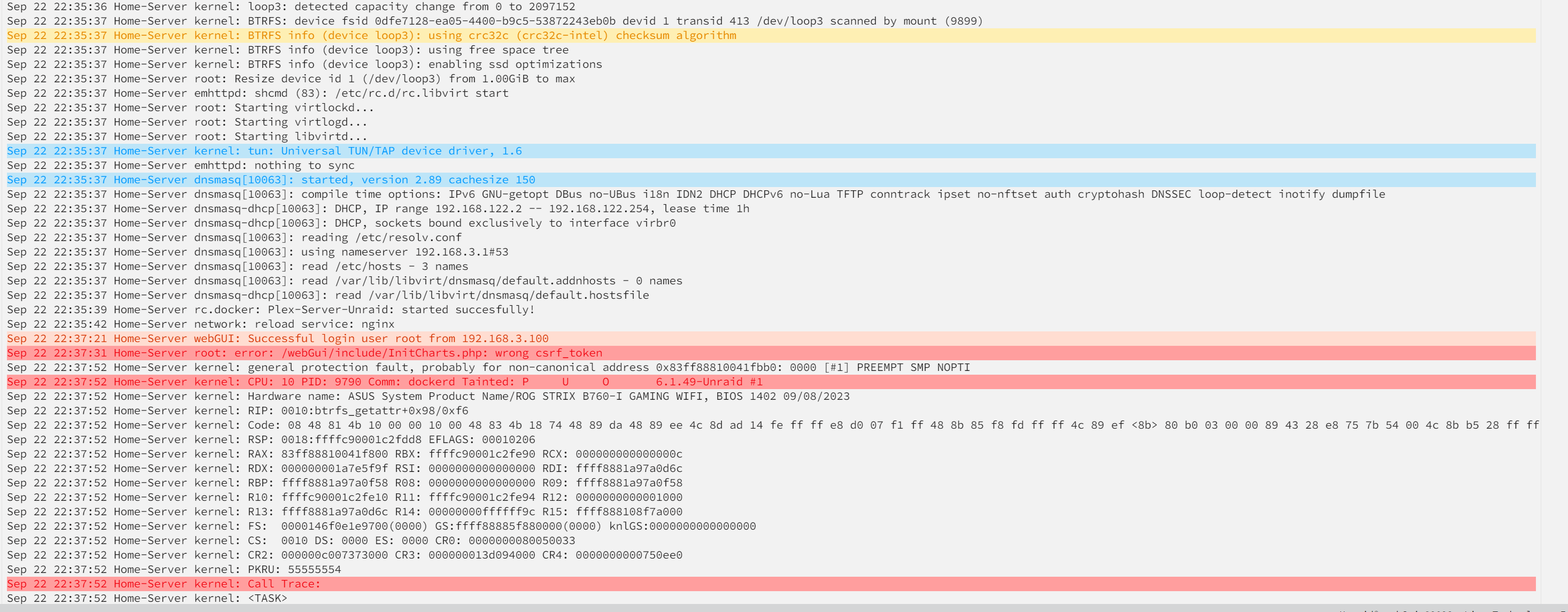

I seem to always get the following before the crash
Sep 22 20:22:27 Home-Server kernel: __vm_enough_memory: pid: 9429, comm: dockerd, no enough memory for the allocation

RAM (swapped) RAM. Also increasingly unlikely both RAMs would exhibit same issue. MemTest passes no matter how long I run the test.
