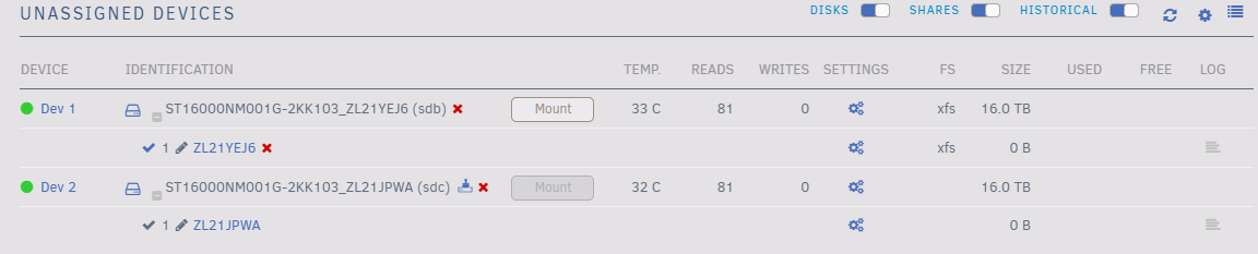

Dev 2/sdc is the old data drive, but Unassigned Devices doesn't seem to recognize the filesystem on it anymore and the mount button is disabled. This is the drive that was originally emulated by the old parity drive (sdb) though, so maybe the data drive is too far gone for ddrescue to be effective.
According to your initial diags dev1/sdb was disk2, see if that mounts and check contents.
Thanks for the sanity check, I should have realized it makes more sense that the old parity drive wouldn't have a filesystem.
I can mount sdb and it shows 1.52 TB used, similar to the 1.54 TB used on the clone drive. I can see data in /mnt/disks/ZL21YEJ6, but the newest files appear to all be from March 25 and I know my *arr Docker containers were writing data a lot more recently than that.
