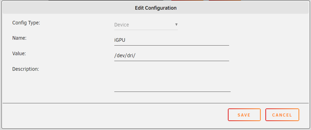

I ran out of things to try getting my 8700k to transcode with jellyfin. This is what I have
- original jellyfin/jellyfin container
- latest intel-gpu-top for monitoring

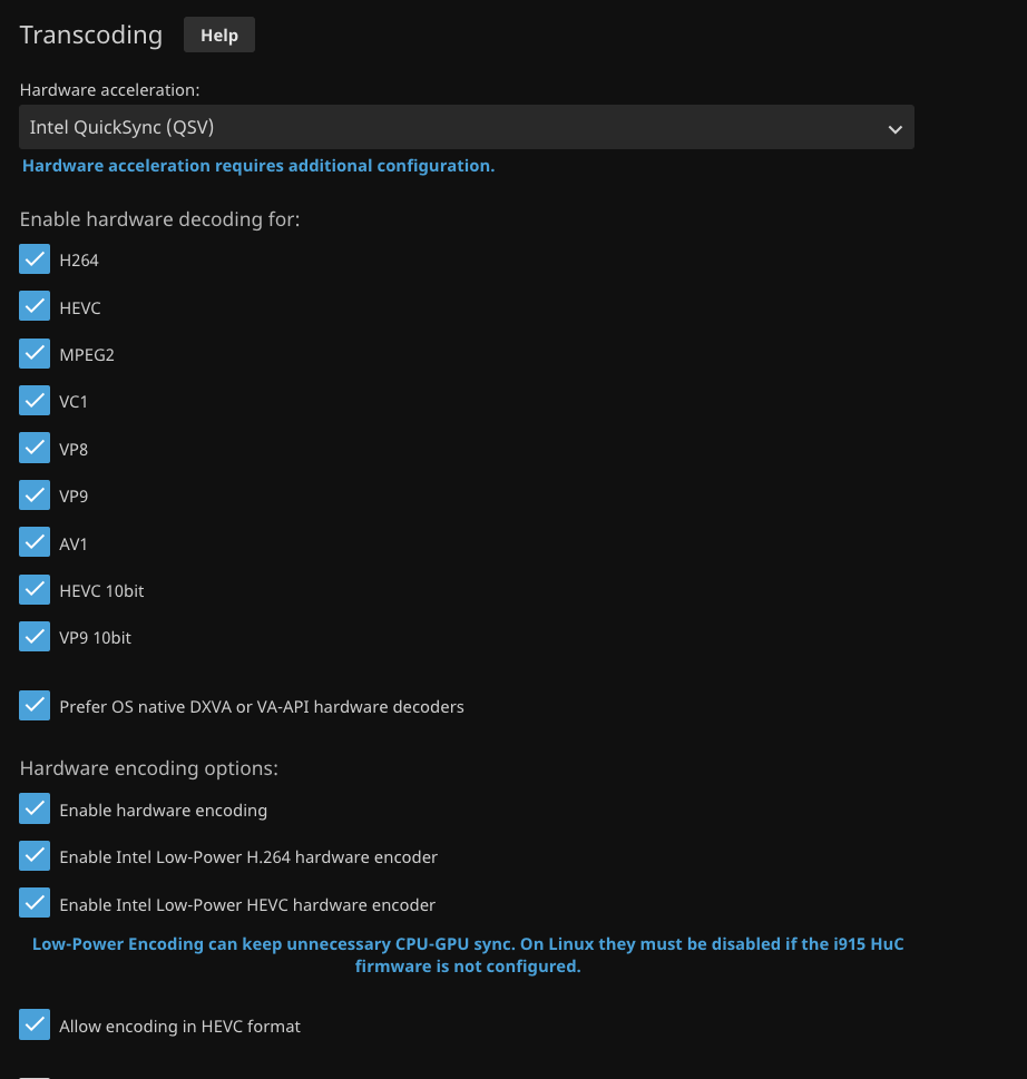

- enabled Intel QuickSync transcoding
- added/removed i915 modprobe from boot/go file (should not be needed since I have intel_top_gpu)
- added device in docker template as /dev/dri/ (also tried extra properties)
- device shows up in both container and host when I list.

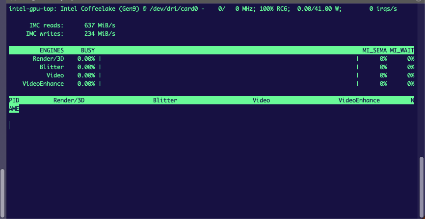

Is there anything more to be done? When I play a stream I expect intel-gpu-top to show some kind of activity.

Thank you, unfortunately that link did not give more details, the CPU is supported and the setup I have should be working.
did you disable low power encoding?

yes, have just tried that, still no activity in intel-gpu-top

Here is an example of me starting and stopping a video
Mhmm. its not even trying to use the hardware decoder. Do you have other video files to test?

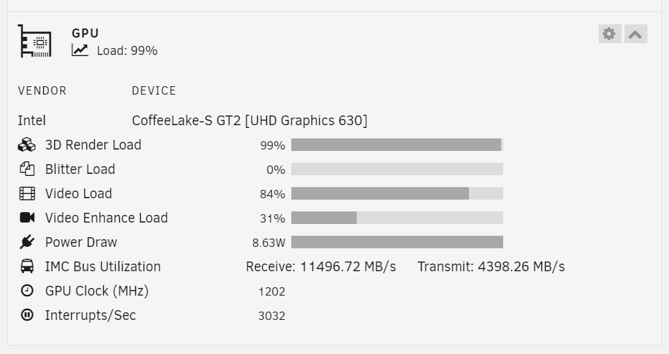

1 minute ago, flowermoron said:
Is this by linuxserver?
My igpu works just fine with it. It's the same igpu you are using.
https://ark.intel.com/content/www/us/en/ark/products/126684/intel-core-i7-8700k-processor-12m-cache-up-to-4-70-ghz.html
2142883005_2023-09-2217_03_07-hmdnexus_Dashboard-Brave.png.9b178a97ad3ae086561b9af0b9da3239.png

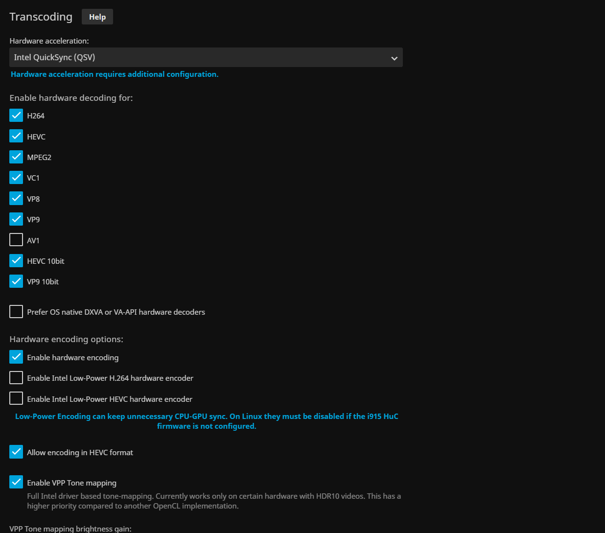

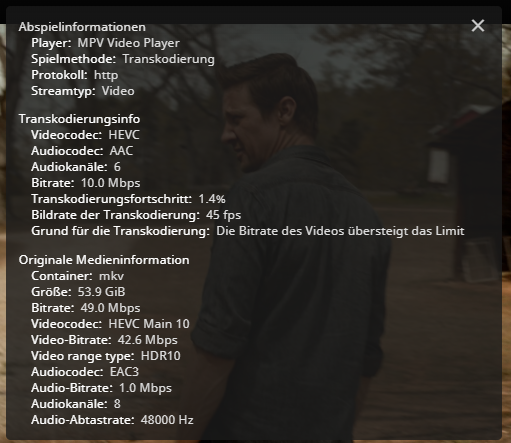

But that one works the same at the end of the day.
Im pretty sure its the particular video file. im absolutely certain the hevc samples i linked will work

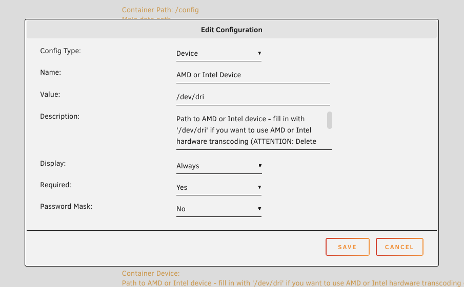

Try linuxserver, i had the same problem before when using the original Jellyfin docker.
linuxserver/jellyfin:
I tried linuxserver container, streams would just spin and never load, will have to double check why.
jellyfin/jellyin:
I forced to 360p and I see the iGPU spike to about 5-10% and then the stream crashes. ( All streams crash now, even the kodi test file )

Add this too to the linuxserver docker.

turn low-power mode off
Thanks, the problem was that I turned off low power mode but I didnt save on the bottom of the page. How silly!
It is always a bad idea to enable everything, I would also recommend that you disable allow encode in HEVC.
You can also get a full list of what is supported by your chip in terms of video codecs over here: Click (your chip is Coffee Lake if I'm not mistaken).
I would also recommend that you switch from QSV (QuickSync) to VA-API in Jellyfin to avoid further issues.
did you get that to work at any point? Ive tried so many times and got it working once xD it always transcodes into h264 even if the client can accept hevc
Please don't quote me on that but IIRC this feature was working if it was selected but was ultimately deactivated by the devs in a point release because it caused huge issues with Dolby Vision content, so tho speak, this options does nothing.
Anyways, IIRC one of the devs said that he is implementing a button to force encode in HEVC and reactivating this option again to a upcoming version.
EDIT: I just tried it now and it defaults always to h264 regardless what is set in the server options, however if you force HLS in the Jellyfin app on your device (for example on my iPhone xS) by using their native player it is working and the stream is transcoded or better speaking sent over in h265.
Would have to look into that. Were only using Jellyfin via browser and the Jellycon plugin for Kodi on firetv sticks. I did look into that since there is a force hevc options but that doesnt seem to do much. Still ends up with h264.
Same with the jellyfin plugin for kodi, but that one plays back the original file just fine via direct play. its odd.
Same applies to kodi on the pc only h264 for transcodes, although that one is even stranger for direct playback. Kodi is able to force my monitor in hdr mode despite the fact that hdr is disabled.
But i do use the linuxserver container, so that might be the reason.
Edit: HOLY MOLY the official player app does work on pc, if you force hevc on! By default it just uses h264 instead of trying hevc when it started with direct playback.
1256183286_forcehevc.PNG.3884113b5a5d6bcff088b6eea14c66f9.PNG855957908_forcehevc2.PNG.0422d243e2bd57e16977b3cfccd24952.PNG
