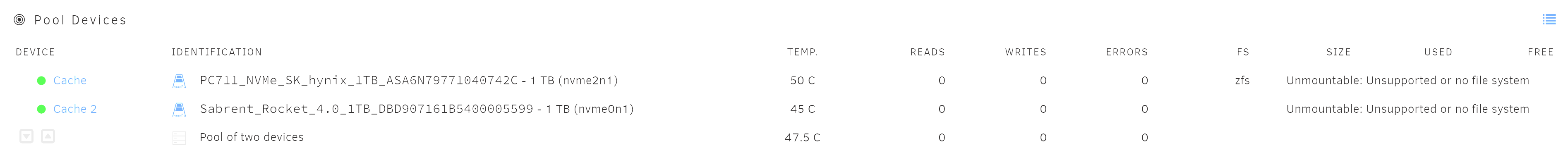

New install problem unmountable pool. diagnostics attached.
I have 2 same size nvme's I was thinking of putting in zfs for cache. I get an unmountable: unsupported or no file system error.
Steps I took:
I have formatted the disk that appear unmountable.  Removed disk from cachepool.  Configured the cachepool for ZFS mirror.  Placed the disk back in the cachepool. But keep getting the same error.
thanks for your help

sorry the problem with unmountable file system is back. See post one. Agghhh!
Steps I took:
ok I figured it out. I was getting a pool on one of the drives that would not be formatted. I took out the drive formated it in windows and now everything is fine.
