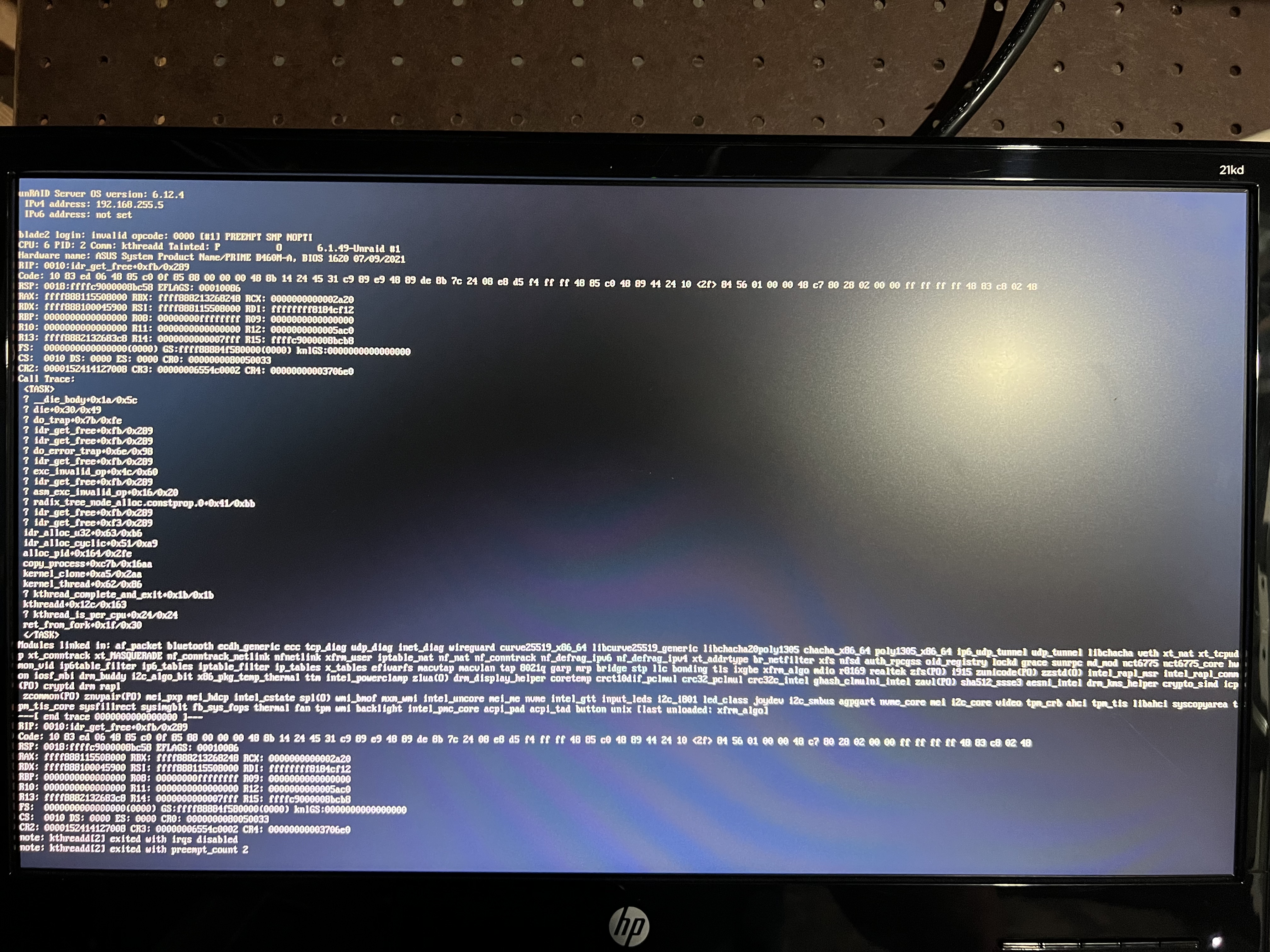

September 21, 20233 yr About a month ago my system would crash after less than 24 hours almost daily. I've tried rolling back versions, uninstalling plugins, updated bios, memtest results with no errors. Now the crashes are happening days in between but still no real rhyme or reason. Can anyone gleam anything from my logs? I really appreciate any time spent on this, thank you! blade2.0-diagnostics-20230921-0911.zip

September 21, 20233 yr Community Expert There are multiple call traces, most mention zfs, I would start by running memtest, if no errors are found remove one of the RAM sticks and try again, if the same try the other stick alone, that will basically rule out bad RAM.
October 5, 20232 yr Author Solution After a crash, my system wouldn't boot and was flashing an error code. Ended up leading me to reseating the CPU (havnt touched it since i installed it 3 years ago) and since then, things are nice and stable again. Thanks to everyone who took a look at this!
