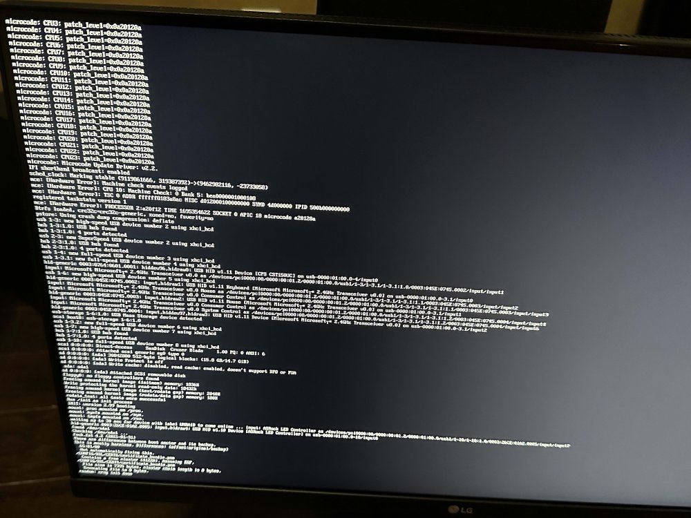

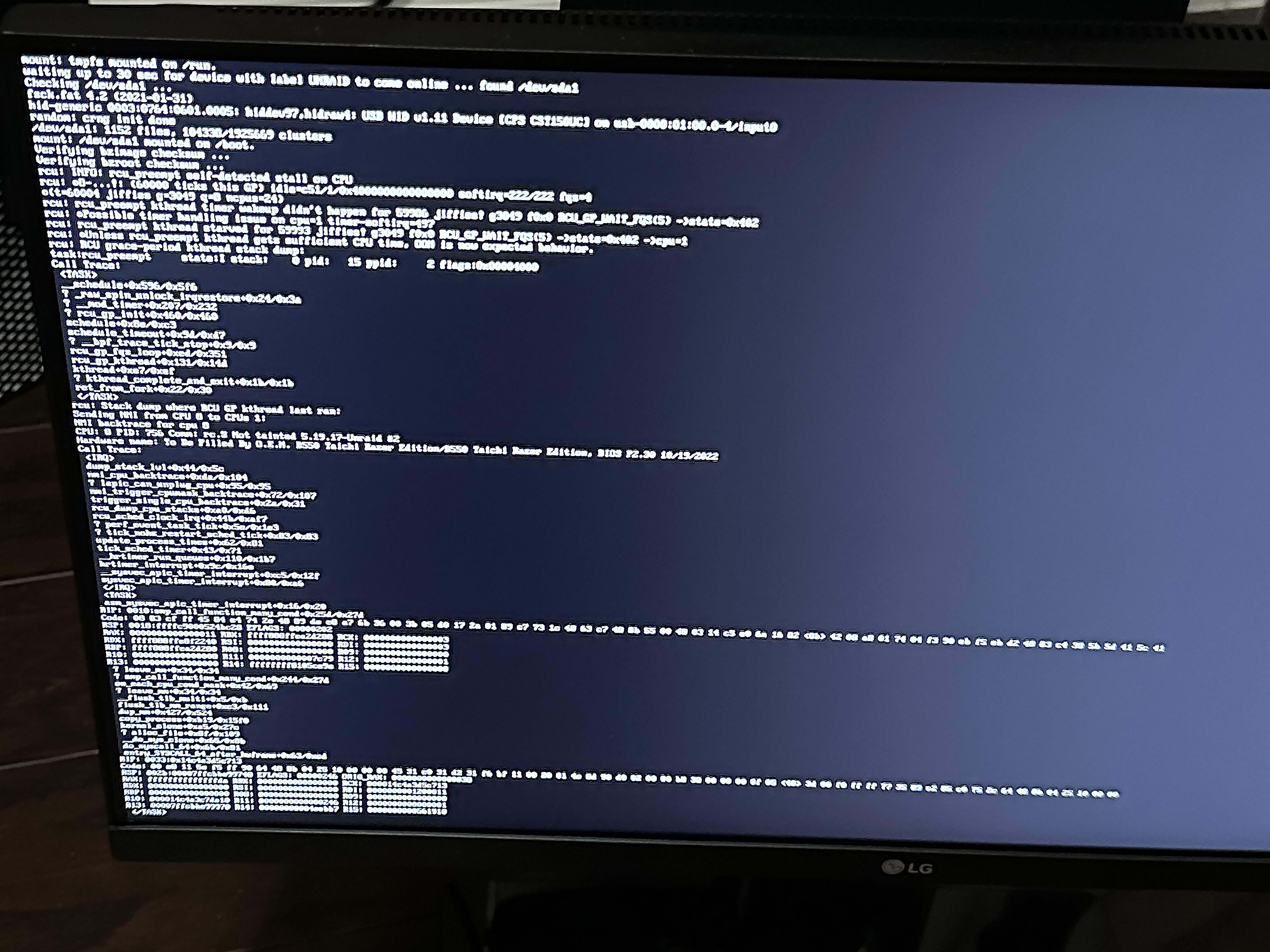

I'm lost at this point. I'm going to run a memory test. Is it possible the motherboard is bad? Here are 2 pictures I took. One was interested because it was saying something about lack of communication between processors. This is the generic named photo. The other was after the UI froze when I got in.

new info
5 hours ago, Mlatx said:
All the live distros I've tried lock up after a few minutes.
This and the other issues suggest a hardware problem, start by running memtest.
I had to download and run memtest from memtest86.com because I needed a UEFI boot. Unraid's memtest, based on that, needs legacy CSM enabled. I needed my monitor and let it run 2 cycles. No issues were found. I updated the bios and still have boot problems.
I tried each ram stick individually, and the problems persist. I doubt 2 ram sticks would go bad at the same time.
It's either the motherboard or CPU. This is not going to be fun. I figure I'll start with the motherboard as CPU's have a lower failure rate.
New mobo arrives tomorrow.
Edited by Mlatx
