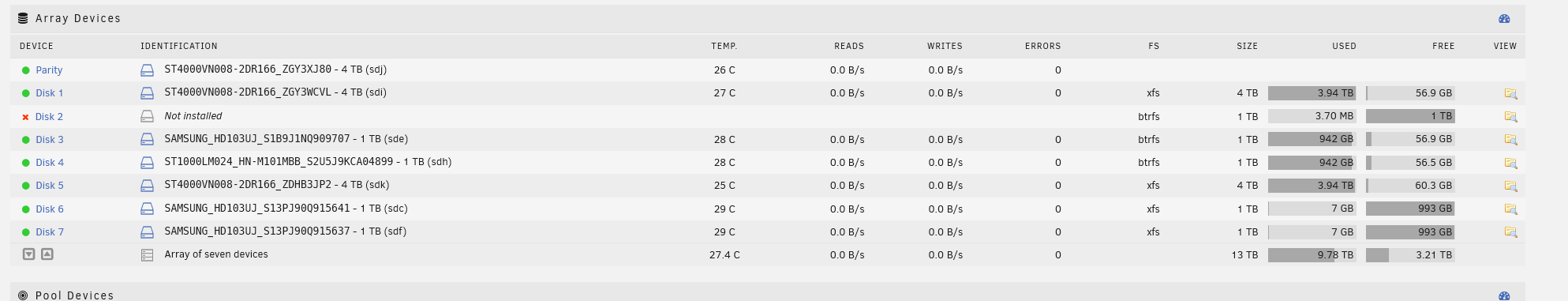

So i think i've fucked up.
Basically one of my 1TB drives failed and became emulated with the above message. I had a spare 1TB plugged in ready to go.
After a SMART check on this failed drive I decided to give it another crack, and wanted to rebuild onto it again as it seemed ok.
I removed the assignment for the failed drive, (Disk 2).
Then, somehow i ended up adding the failed drive back in a new slot (Disk 6), whilst also adding my spare 1TB back, as Drive 7. I think during this process the disks (now 6 & 7) were formatted. So the failed disk has been formatted. But the parity should still be good right?
So now i have two new drives, 6 & 7, with 2 showing as 'missing contents emulated'
However - there doesn't appear to actually be any contents that is emulated. Its just empty, 0 directories. and various dockers are seeing these files as deleted. At this point i have no idea how to know what exactly was on that 1TB and could be lost.
Please advise!!

Sep 17 22:00:56 Tower emhttpd: shcmd (95378): /sbin/wipefs -a /dev/md2
Like mentioned the emulated disk2 was formatted, so any data there is gone, format is never part of a rebuild, there's a warning about that, do you still have the old disk intact?

This would have wiped the file system then.
If you have not written new data to the drive it is possible disk recovery software something like UFS Explorer on Windows could recover data.  However they tend not to be free to use although you can normally run a free test to see what it might recover.
I didn’t realise that the format was also going to format disk 2, specifically the emulated parity data of disk 2. I didn’t think format would apply to anything not a real disk?
My intention was to format the new drive (not emulated disk 2)
the actual disk has been formatted as it is now disk 6, but data hasn’t been written to it so I may be able to recover something.
