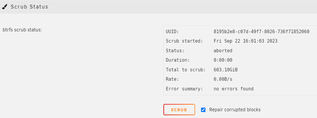

When I try to run scrub via GUI I get "aborted" as the status:

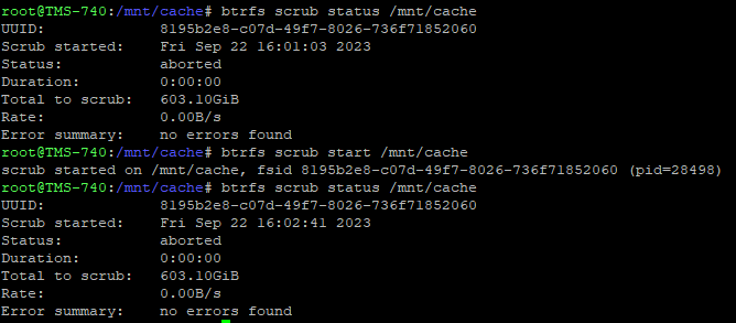

And pretty much the same thing via shell:
I forgot that I had run the scrub via GUI last night when doing initial troubleshooting. Initially I got the same "aborted" but after I stopped the VMs and Dockers I was able to start the scrub which run for ~ 6 minutes and reported millions of unrecoverable errors. Unfortunately I did not get a screenshot of that result before hitting the Scrub again now...
If the scrub is aborting recommend copying what you can from the pool and re-format, also see here for better pool monitoring, in case the device drops again.
